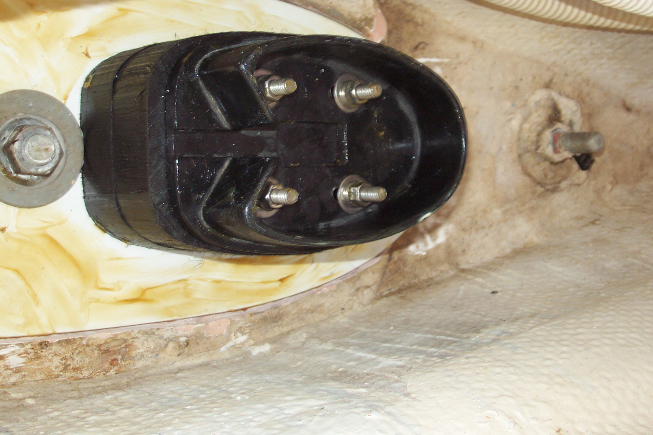

Thanks for everyones help, just about ready to gather the parts and start this project.
One last question, the bolts holding the foot plate to the hull, Does the bolt/threaded rod extend down into the keel, are they tightly secured, no chance of pulling them loose ?
I've been smothering them with PB blaster over the last few weeks. Hopefully they will break free easily
1,085
On my boat, which is the deep draft model, the bolts securing the mast step are actually keel bolts and extend right into the lead. Looking at the pictures in Mathurin's thread, it appears that at least one of the bolts for the mast step assembly is a keel bolt (the forward one) but I'm not sure about the two smaller ones.
