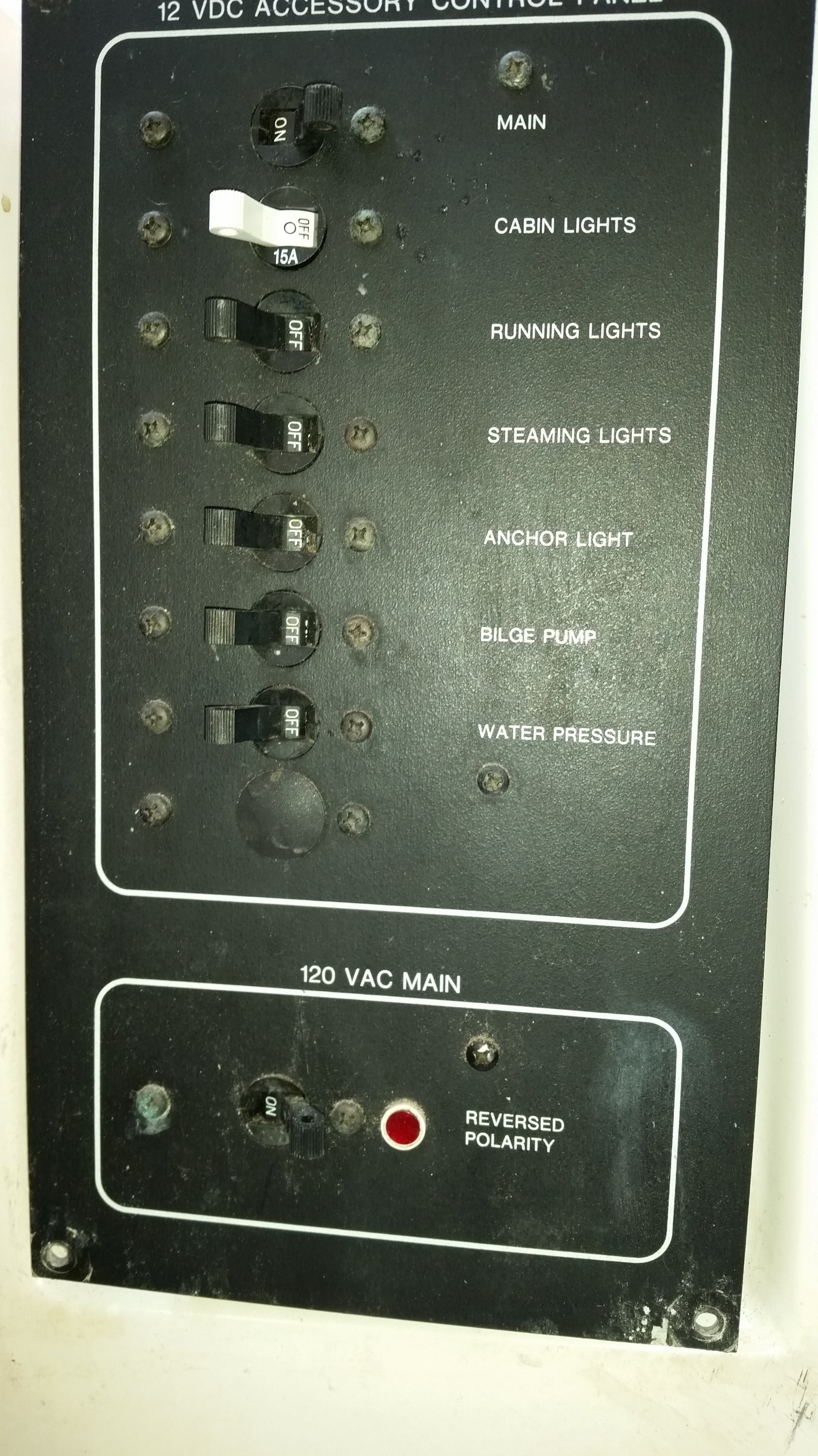

I purchased my 1979 Hunter 27 a few years ago. It was a project to get her back to decent condition. That said I did most of the work while dockside and sailed every weekend I could. I believe in doing the critical work, then go sailing and make incremental improvement on the cosmetic stuff as time permits. Electrical certainly falls under critical, just a slightly lower priority than keeping the water out! Fortunately my electrical was in serviceable shape. The photos below are just after I bought the boat.
I found the wiring to be fairly simple in these boats. The shore power connector is a standard 30 amp twist lock marine connector that you can buy on this site. It goes straight to the power panel main breaker with a polarity alarm tucked up inside the coaming, accessible from the quarter berth. It appears to be 10 gauge Romex in my boat. The power panel AC main breaker feeds three outlets; one behind the galley sink, another up under aft end of the port side berth close to the navigation station and the other over the sink in the head. All of those runs are 14 gauge romex. They are all in one continuous run, over to the galley and back, nav station and finally the head. That was it for the AC. Upgrading to a GFI outlet in the galley and downstream feed the others, or a breaker if you’re buying a new power panel is obviously a good idea. I added another 110 AC outlet in the battery compartment for a battery tender/charger I added. It could be debated that I should have hard wired that to keep the potential for sparking down, but it’s very low draw device, nearly intrinsically safe, but not! The top portion of the power panel is all DC breakers being feed directly off the battery with the large red wire on the port side of the panel. An inline fuse is a good idea for the DC main feed. The trickle charger keeps the DC flowing dockside, so I can use all the DC lighting and radios at the dock. It also assures there is always power for the bilge pump when I’m away. The DC wiring in my boat is “run of the mill” 12 volt low amp insulated copper multi-strand, looks like about 16 gauge. These feed cabin, nav and steaming lights. All light fixtures are original except the mast lights, those are new. Every bulb was replaced with LED bulbs. Bulbs and fixtures are also available on this site. The LED’s make it the best lit boat on my dock. One other upgrade I made was power connectors for the anchor and steaming lights, so it is easy to disconnect when stepping the mast.

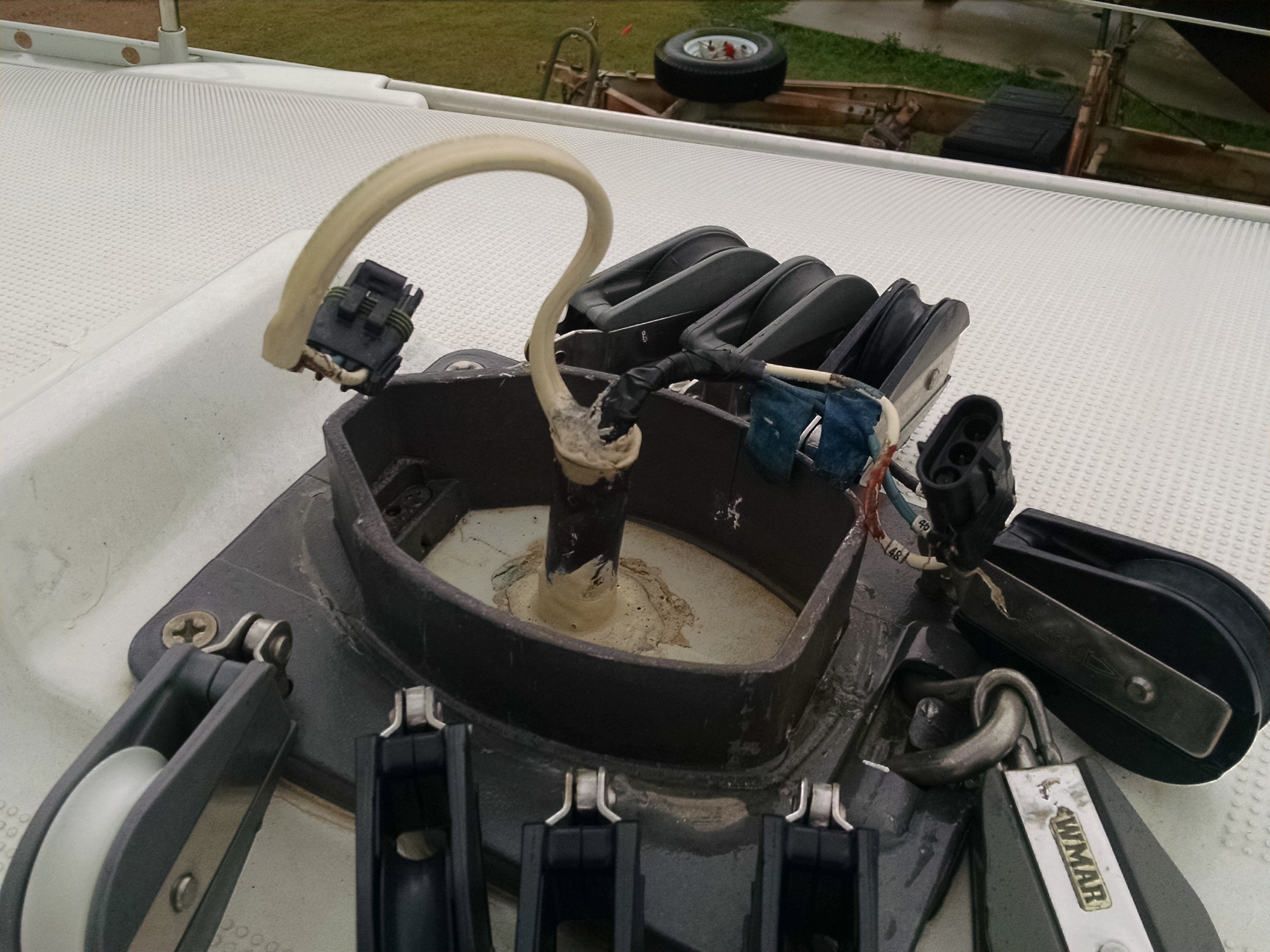

I did the same on the wiring up the mast. Used waterproof (Weather Pack) connectors and used opposite connections at the mast base (one male and one female) and on the wire (opposing female and male) going up the stick so there is no way that the connections can be reversed and made incorrectly; See the pic.

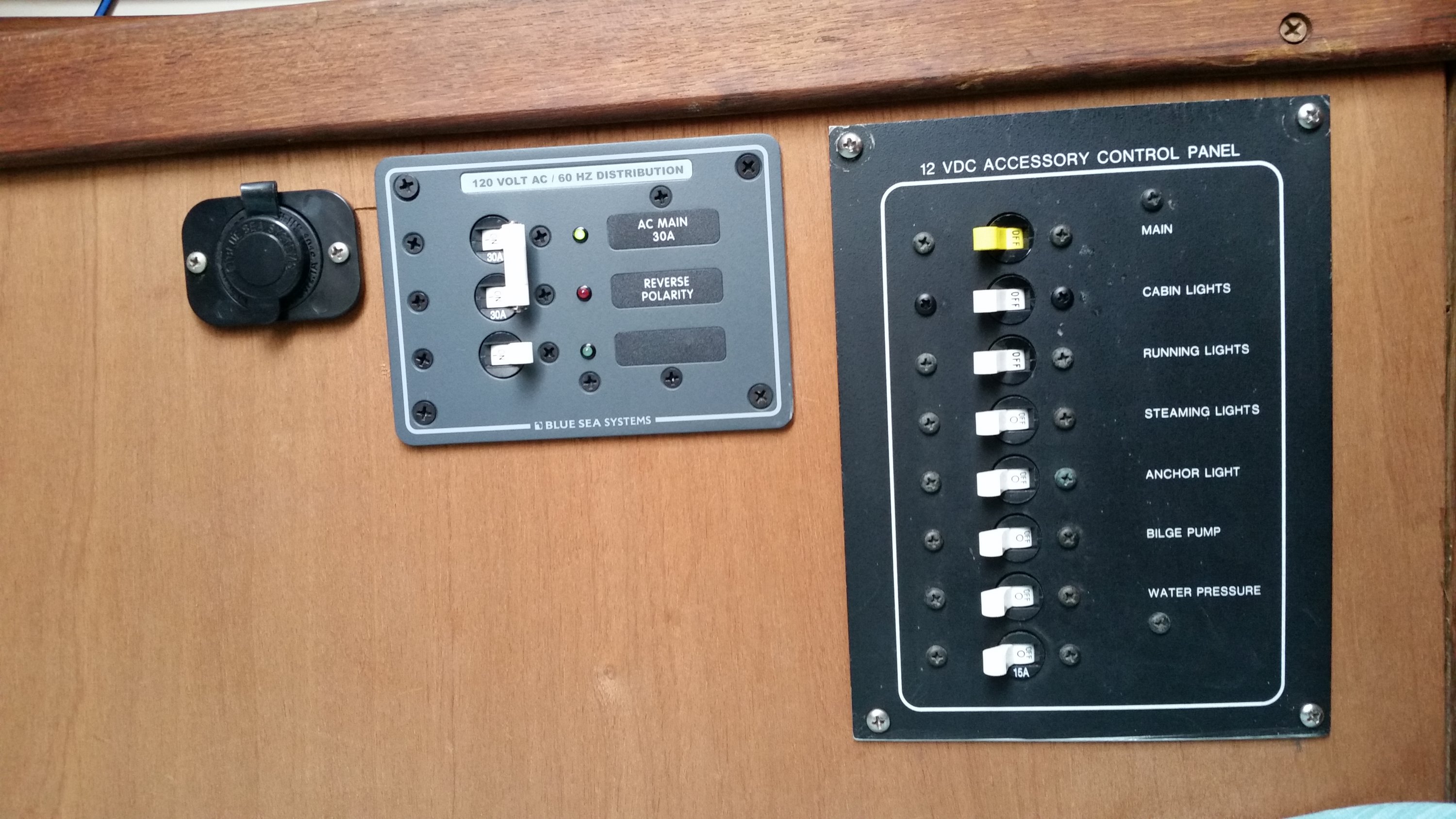

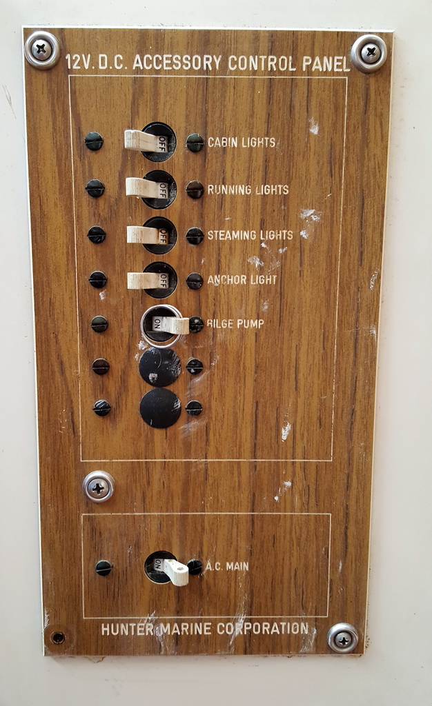

To add a little to the great info that you have gotten from other Cherubini Hunter owners, I have recently made some changes to my H27's electrical panel. The current trend in boat panels is to have the dc and the ac on separate panels (for safety reasons, I assume). Because my original panel was in good shape, I simple cut off the lower ac section and bought a small Blue Seas ac panel. You might consider something like that or buy a new dc panel that has more breakers (can't seem to have too many). Here are the before and after pics of my setup:

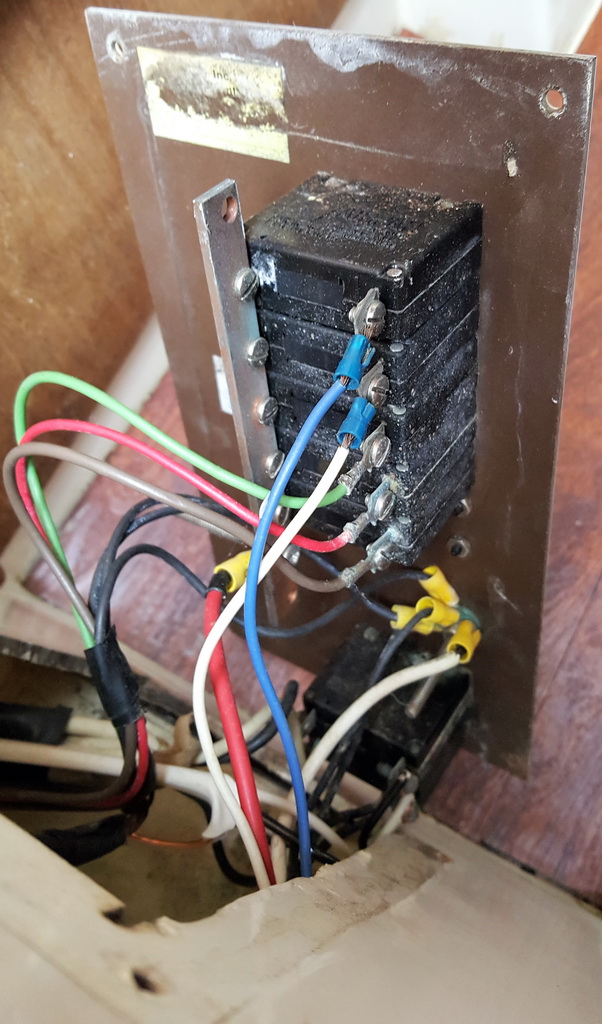

At soe point intime there was water in the boat I do not know the reason but the lower paart of the panel got well I will change it outand go with ac and dc but the question is where I am going to put the ac the panel was on the area by the companion steps by the nav station there is a cabinet there At some point in time battery charger a battery select switch was added as well as radio cd player fans all this stuff was just wired into the panel It was a can of worms . I have taken a lot of it loose marking where every wire went the ac connector was back in the wall not in the location on the cabin outside wall. I sent photo to blue sea and ask them to help me figure out what I may do/ I have plenty of tined 18 ga wire that was pulled out on last outage (I work for a contractor that does power plant maint here in Ga) The original panel was 5 X 10.5 There is some pic on the form that shows where the panel is. I figure I will hear from blue sea on Monday or tue The wiring diagram show the dc running along the side going forward but mine runs under floor from keel bolts going forward I may try to rum the running lights forward along he wall and mast somewhere have not found them yet The main thing I want to get done is electric panel and bilge pump. The mast ids down and on boat when I get electric and bilge pump done I will get it in water may not step the mast right away need to get new lines.
