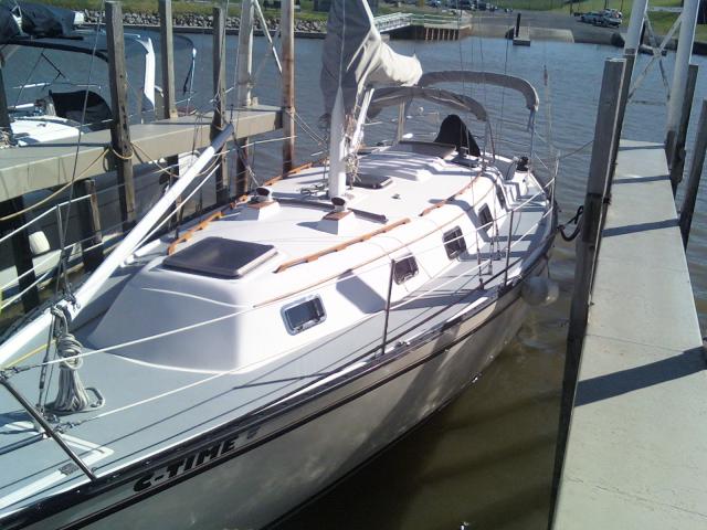

Hi All,
Has anyone tried to match the color on the original gray (I think) deck paint on the non-skid areas of the deck? I want to repaint and I'm looking for a product recommendation.
Thanks,
Tom
Mar 6, 2012
357
Hunter H33 (limited edition cabin top) Bayou Chico
not sure about color matching but im going to use kiwi-grip when i repaint.
Db421
Jun 7, 2004
95
Hunter 34 1986 Lake Lanier, GA
Just redid my non-skid with Kiwi grip. Very easy to tint & apply. I would HIGHLY recommend!
Nov 14, 2006
93
Hunter 27 Lake Lanier, GA
