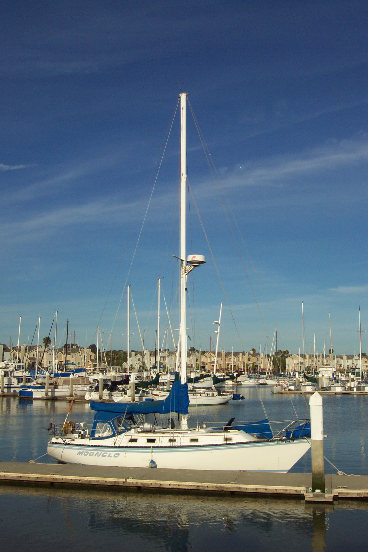

I can't get you the exact measurements but the attached picture might help. That radome was at least 30" in diameter and did not seem to bother the previous owner. The staysail was reinforced in the area of the radome. Getting the jib around the inner forestay is way more of an issue than the radar.
I removed that old radar because everything about it was huge, including weight, bundle of wires and power draw. (Something like 50 amps at 12 volts DC)
