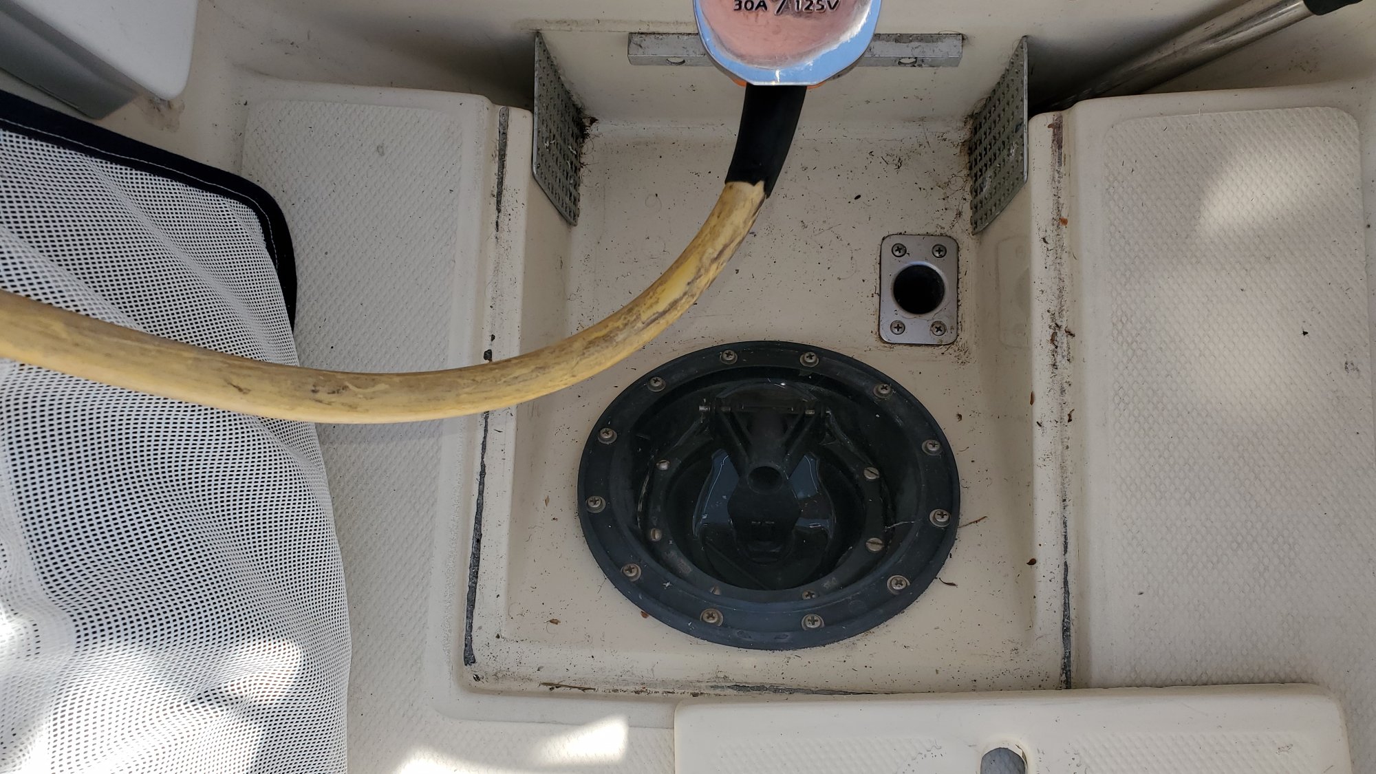

I have a Gusher under the cover. I'll be at the boat next week some time. I'll take a few pictures.

Hi, did you get what you needed? I will be down at the boat in the morning if you still needed some pics

A pic would be great
I have the tee below deck
Not sure how the pump attaches
Thanks
Dan
Sep 15, 2019
20
Yamaha 33a san juan islands
Thanks
That explains alot
The membrane is the missing link
The PO put an inspection plate in to replace the pump
Looks like I will have to relocate a pump elsewhere
Appreciate your time and pic

On mine, there's a strum box for the manual pump in the bilge. The hose routes under the floorboard and then under the galley sink. It loops up into the engine compartment and connects to the intake of the manual pump. The output of the manual pump joins the forward cockpit drain hose via a manifold and dumps through the forward cockpit drain throughhull.

That makes sense
I found a Henderson pump on the boat
I think that was the pump but there seems to be no way to attach it
Appreciate everybodys pics and thoughts
