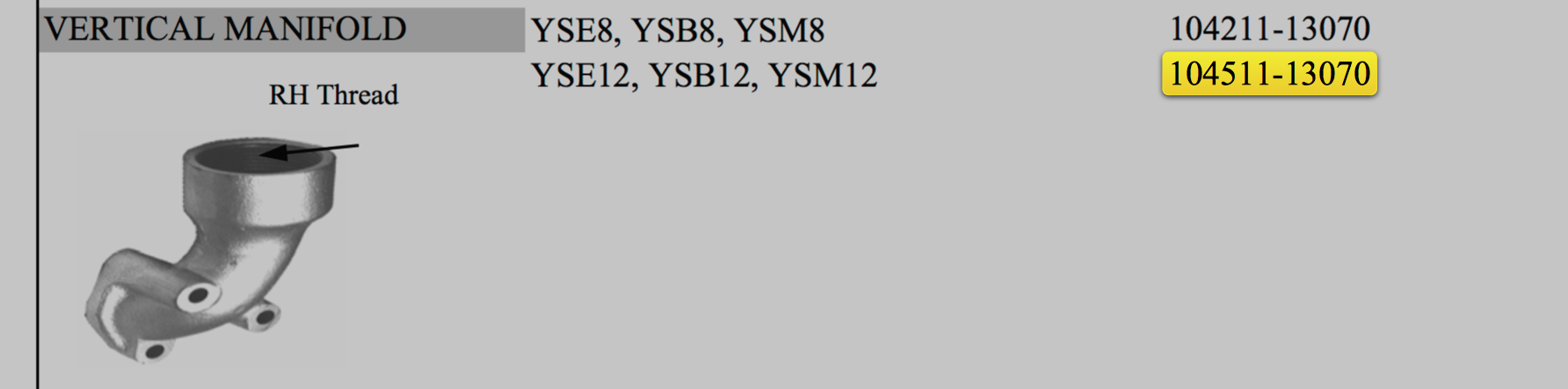

The riser per the Yanmar catalog is called a "Vertical manifold" part number 104511-13070. The nipple is part number 104214-13580 and has a left hand thread on one side

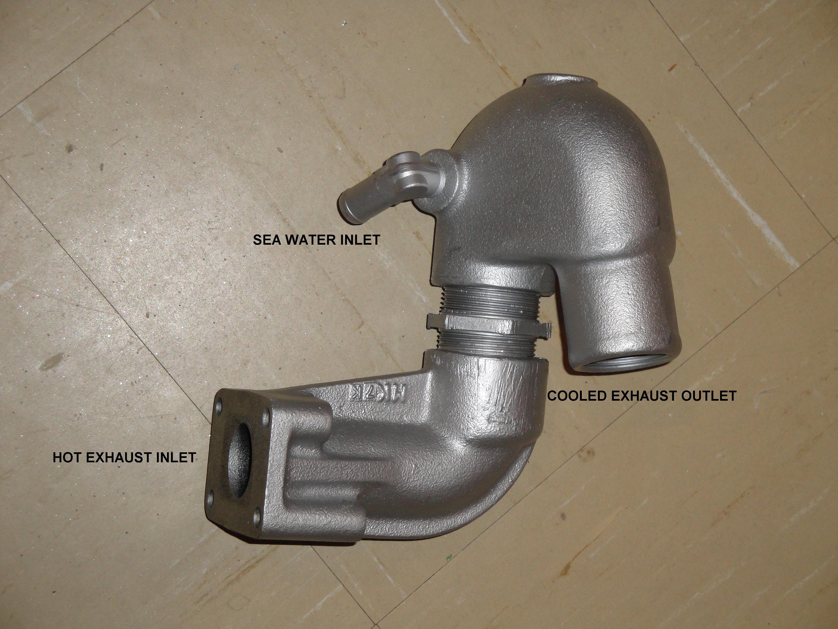

This is the part I think you are referring to in the picture. I need the pipe that attaches to this and goes up to the mixing elbow.
104214-13580. Yanmar is pretty proud of those is looks like. One side is rh and the other lh

You will have to disassemble to determine the location of the leak. Here's the little bugger from a 2GM20F ready to go back in.
The best tool for removing the piece between the elbow and the bottom cast piece is the "right hand of God". Top is a LH thread and the bottom is a RH thread.

Ah a picture is worth a thousand words. I have 18" to 2' of pipe between those two elbows. That is the part I am trying to figure out before I decide what spares to order.
