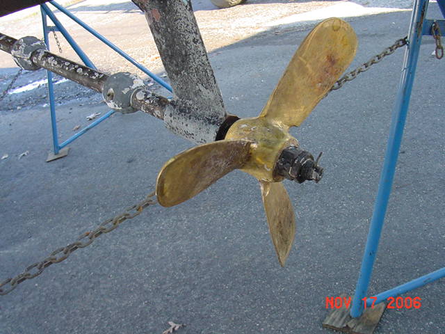

For my '79 Hunter 30 with YSM12 Yamar diesel I went this direction-
, we would recommend a CS3LH12x7x1 for your installation. This is a Campbell Sailer, three blade, Left Hand rotation, 12" diameter, 7" pitch for a 1" shaft. This size is recommended to give you a good cruising rpm and still have reserve for head wind and seas. This propeller would cost you US$329.00 plus a shipping and handling fee of $35.00. It would take us 6-7 days to make this propeller and approximately 4-5 days for delivery.
It seems there are few choices for our 12hp Yamars and a folding reversible prop is not one of them. I did find it gives me more power in heavy chop and reduced to prop-walk a little. One thing that happened a season later was a problem at the shaft coupling. I had two bolt type screws that secured the prop shaft to the drive unit. These wore a grove in the shaft to the point that I needed to replace my shaft. Keep this in mind if you change your prop from the old two blade.
Good Luck
Ian

I had a 1980 H30 but with a bigger engine (2QM15) and a factory two blade prop. The prop walk in reverse was bad. I changed to a three blade Campbell sailer and was impressed with the improved performance and boat speed. Some reverse prop walk was still there but not as bad and I felt like I had more control of the boat.
