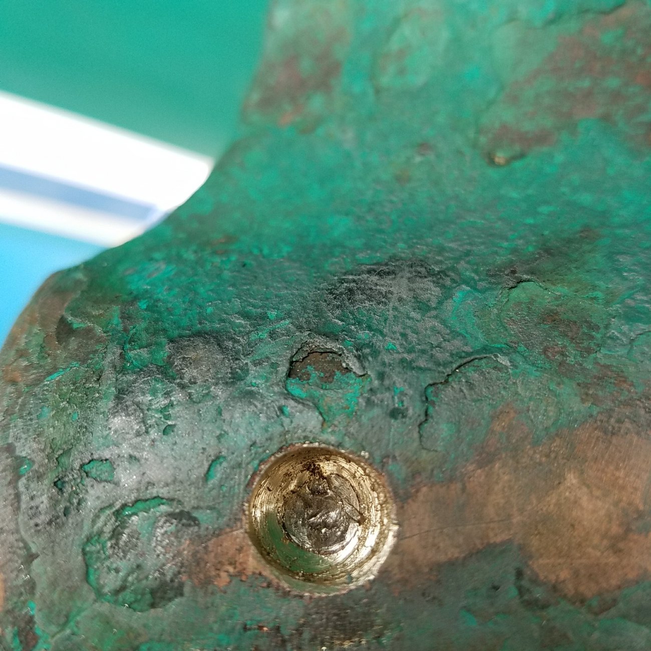

Shadow. Your setscrews make my point, my strut has nada.
. I haven’t taken a formal count but I’ve seen like 50 customers who pulled their bearings, est 2/3 were C27, 28, 30, 34, 36. Majority but not all had no set screws. Its a box of chocolates .
The friction on the shaft is nil compared to the fit of the cutlass that, unless there’s a fit issue, ss aren’t needed. They can be added tho. But they’re more of a potential detriment if not needed. This pic is a guy who, even tho warned, tried to push the bearing with one ss still seized. He got a REAL expensive lesson!
