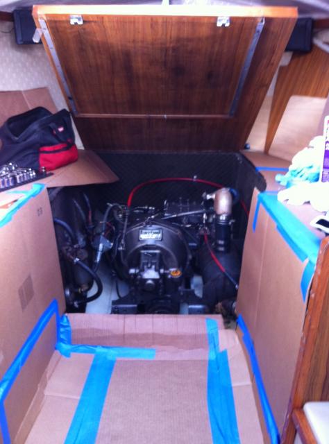

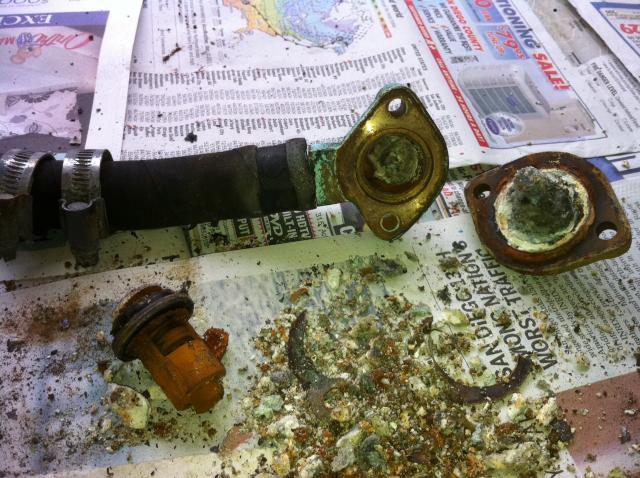

One of the first items was taking care of the motor. Upon purchase, it started and ran, but the PO was not much of a sailor/boat owner and I thought I had better go through things, and get the Yanmar YSB8 squared away ('before" photo is on the far right). Additionally, I had suspicions about the fuel tank so I pulled it, had it cleaned and polished, and reinstalled with new hoses. It had about an inch and a half of sludge along the bottom.
Take a look at the condition of the thermostat below. That will give you an idea of what was encountered. Also is a photo of the motor before, the motor during prep, and the "after". I also had a crack in the muffler that was detected. I purchased a new Vetus and installed it under the forward stbd seat area.
The old Yanmar now looks brand new and runs like new!

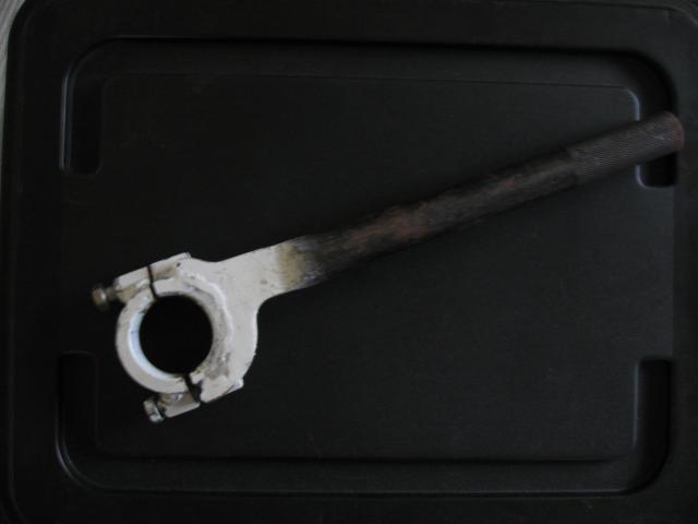

Haven't done my cockpit drain but did do a fwd ball valve. I was worried about torque on the hull fitting also. Made a holding tool out of a like sized pipe coupler split in half and clamped onto the thru hull fitting like a split collar with a handle welded to it.
I'll post a pick as soon as I dig it out of the garage and find my camera.
Syntonos
Jan 4, 2008
149
Yamaha Y25 mkII Long Beach, Ca.
Heres what I whipped up to hold my thru hull fitting---crude but effective.
1) Take a pipe coupler fitting the size of your thru hull fitting
2) Weld a coupler nut on each side
3) Cut the welded parts in half - drill out one half of coupler-nut for pinch bolt clearance
4) Grind an additional 1/8 off reach half
5) weld on a handle
Presto! A holding tool
:eek: And no I am not a welder.

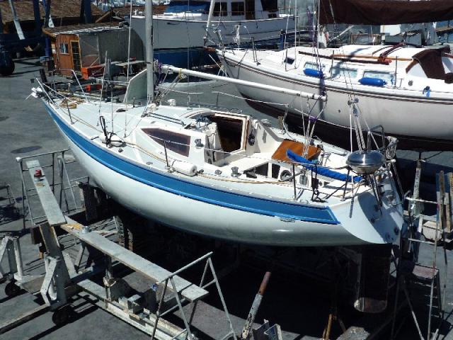

Well...a lot of progress this weekend. She is on the "hard" at Shelter Island Boatyard! I have a great network of great restoration craftsman and while here I had the bottom sanded, prepped and painted and the boot and shear stripe re-painted. I chose Vivid Red to replace the tired blue. The 1" stripe will wait till she is splashed and will be a Sky Blue.
I have had the Gate Valve (mentioned above) inspected and it is in good shape. However, I am going to have it disassembled, lubed and re-assembled.
I have a few gel-coat issues that I will address, and then my hull should be up to my standards (high).
The Photos below show "before" and "after" of phase 1.
Love this boat!
