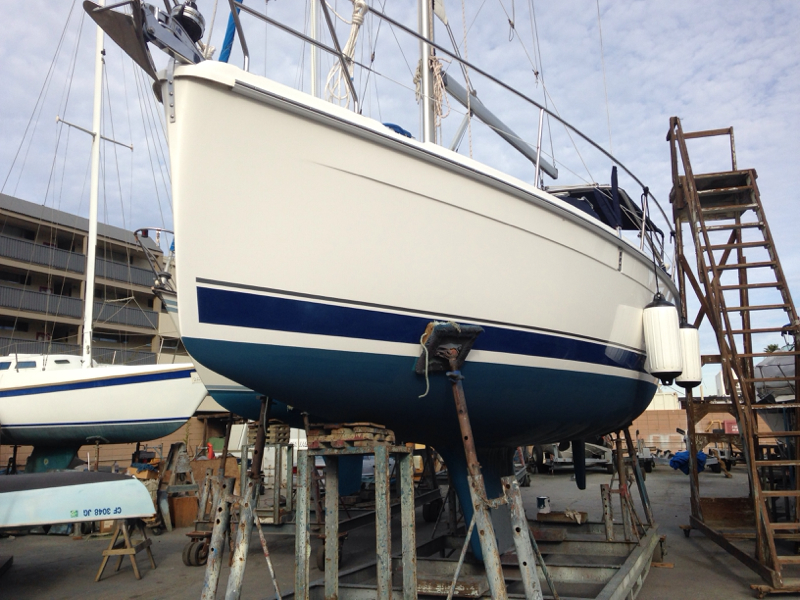

I hauled my 2006 Hunter 31 for new bottom paint earlier this week and decided to change out the prop as well. I picked up a new 16" Max Prop 3 blade feathering prop and was wondering if anyone has installed the same prop on the same model boat? If so, what pitch did you go with? I have searched the forums and have found no information posted by someone with the same make of boat and prop? I was going to start with using the same pitch as my fixed 3 blade I am replacing? Any tips from someone who has installed this same prop on the same boat is greatly appreciated.

Thanks for the input guys. I'll update this post after I get the prop installed and try it out. While out for paint we noticed the through hull prop shaft bracket bolts (2 of them) we showing signs of leakage some we gonna pull them, sandblast the shaft, re seat the bracket and change the packing gland...
