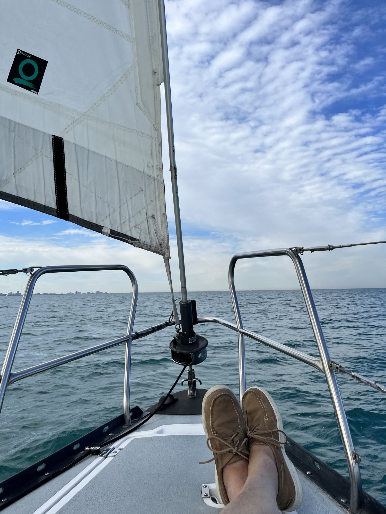

I often solo sail and always liked my old 150 for light wind days, but I hated the pour visibility. Plus, the foot of the sail chafed on the pulpit rail. When I had a new genoa made about six or seven years ago I stuck with a 150 and raised the foot of the sail enough to clear the rail. Honestly, it’s reefed down to 135, 120 or less more often than not (Luff foam is key to good sail shape.), but the visibility issue is solved and I still have the larger sail area when I want it. I don’t miss, or even notice, whatever sail area I may have technically lost off the foot of the sail. It’s worth the peace of mind of the improved visibility.
23,525
That image sure makes me instantly understand your enjoyment from “peace of mind”.
Pictures are worth maybe a thousand words.
