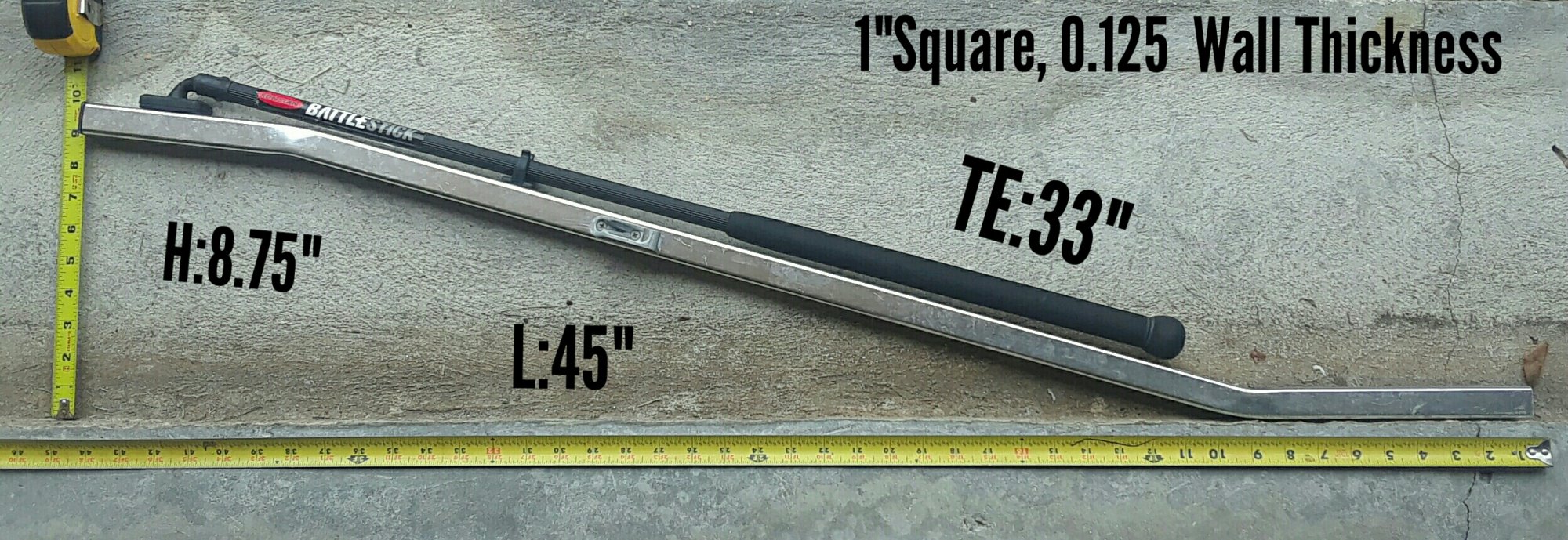

I can measure my 146’s tiller arm tomorrow and let you know. But speaking of prices . . . my centerboard broke and they want $799 for a new one AND a 60 day delivery time !Would someone happen to know the dimensions of the aluminum tiller arm on the 146. I would like to make one instead of paying $160. I've searched around and I have not found any solid info. Thanks!
The OAL of the tiller is 45 “. Then there is a 33” extension handle that sits on top of it.Would someone happen to know the dimensions of the aluminum tiller arm on the 146. I would like to make one instead of paying $160. I've searched around and I have not found any solid info. Thanks!
I can send you a photo if desired.The OAL of the tiller is 45 “. Then there is a 33” extension handle that sits on top of it.

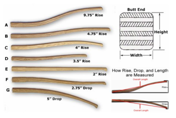

Rise ?Thanks for your help. What is the Length of the total rise? Appreciate your help.
Right - I will get that measurement for you.Sorry that I wasn’t more clear. The tiller arm isn’t straight vertically correct? It looks as if there is some rise from where it leaves the rudder to where it terminates.
The rise of my H146 tiller is ~9”.Sorry that I wasn’t more clear. The tiller arm isn’t straight vertically correct? It looks as if there is some rise from where it leaves the rudder to where it terminates.
