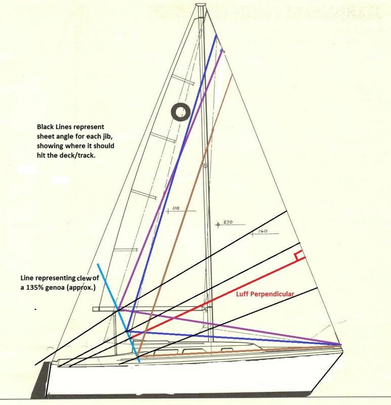

Block location is based on proper sheeting angle, usually the sheet should match the angle of the LP (Luff Perpendicular) for proper sail shape. This will keep even tension on both the leech and foot of the sail. LP is the line drawn through the clew of the sail intersecting the luff at a 90 degree angle. Genoa "percentage" is based on the ratio of the length of hte LP to the "J" measurement (distance from base of mast to base of forestay). The J for the 25 is 10'6" so a 135 Genoa will have a LP of 135% of 10'6" or 14'2". I'd make sure that my Sailmaker cut the sail to have the sheet land about the middle of the current genoa track, or maybe 2/3 of the length from the aft end. This can be acomplished by adjusting the height above the deck of the clew of the Genoa.
This way there will be no need to add another track. See diagram below for what I hope will explain all the technical "mumbo jumbo" that I just wrote. <GRIN!> The blue line represents approximately how far aft a 135% genoa would extend (well, maybe, I'm not exactly sure that is 135%, might be larger, but you get the point.) Anyway, if you draw a line perpendicular to the forestay that hits the deck at the point on the track where you want the fairlead to be (in order to use the track that is already there), that will need to line up with the LP of the 135% Genoa. Well, I know what I'm trying to say...... but even I'm getting confused about just how to explain it!
If you can have your sailmaker visit the boat with you, he/she can get this right. However, it seems to me that a 135% genoa sheet should hit the genoa track with no problem, locating the fairlead on a track further forward (between current track and the working jib lead block) would be too far forward.

Thank you very much for the detailed explanation, and the EXTREMELY helpful images. Those make it much easier to visualize how the sail cut affects the sheet angle.
I had planned on purchasing an off-the-shelf sail on-line, as I don't want to spend the $$'s for a custom cut sail. Based on the image, it looks like I would be covered with my current setup regardless of sail cut with the sail fully unfurled. Could run in to a less optimal situation if the sail is cut lower as depicted by the brown line.

After reading Sunbird's explanation a few times it finally sunk in about jib size. I always thought it was J * 135% along the J line. Didn't understand the LP length. Now I do.
Sunbird,
What do the 110, 270 and 160 marks represent in your second attachment?

The 110, 270, ansd 160 marks represent the approximate centers of effort of the working sails. 110sqft for the Main, 160 sqft for the working jib, and 270 sqft for the main and jib combined. The locations of the marks, as I say, show the approximate center of the area of the sail (and the 270 show approximate center of the total sail plan). The jib shown is the "standard" working jib, which I think was about a 100% jib, based on how O'DAY lists the sail area in their brochure.
For clarity, I have attached a copy of that drawing without my added lines.

Thanks for clarifying that. I have seen that drawing before but never understood those numbers.
