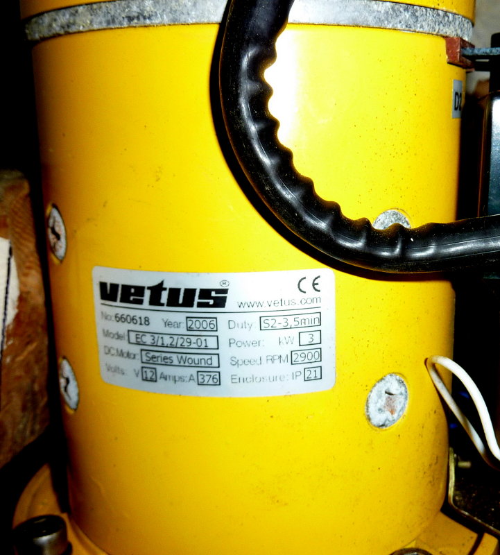

Please do. Today I get to deal with a 376A Vetus bow thruster that was powered with a single group 24 flooded battery & charged through a diode isolator after a 120A combiner and 24' of 4GA wire. The wire has signs of melting in numerous places, go figure...........:eek: Some people should not be allowed to touch wires......:doh:
Owner: "My bow thruster really sucks."
Me: "Well, yes it would, when wired that way."
On top of the massive voltage sag a single Group 24 battery will have driving a 370A+ load this owner also had another 2.3V or 20% voltage drop in the wire, and I am not even including the piss poor lug crimps done with a hammer or what his motor voltage was during the 700A+ in-rush..
Lets' assume the battery sags to 9V under a 376A load, then we subtract another 2.3V for voltage drop. This puts his thruster motor at just 6.7V!!!!!!!!!!!!!!!!
Yep, your thruster performance does SUCK......
