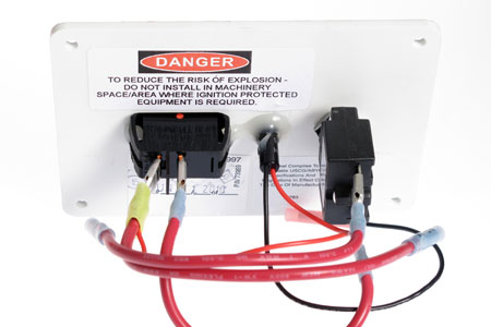

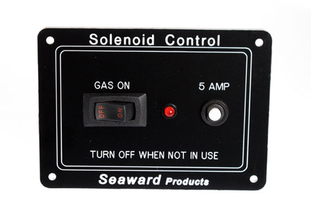

The only thing that dosn't make sense is why Seaward would put a solenoid in their locker that didnt have this "reverse" surge protection in it. Nor does it have it in the wiring for the panel that they do recommend to go with it. Here an image from catalina direct... See? No diode!
The ideal place for this diode is right across the solenoid or relay coil. The main reason to put in those diodes, in the pre-LED era, was to reduce the vicious -SNAP!- that the release transient would otherwise generate in nearby audio and video equipment.

My point is, if it was wired without a diode, the LED in the front of the panel should theoretically blow out, just like the one in my wiring did.
Seaward sells the LPG locker preinstalled with the solenoid as well as the switch. If one were to hook it up without knowing the first thing about diodes, it wouldn't last past the first turn on!

Seaward might be using a LED pilot light assembly with sufficient built-in protection.
