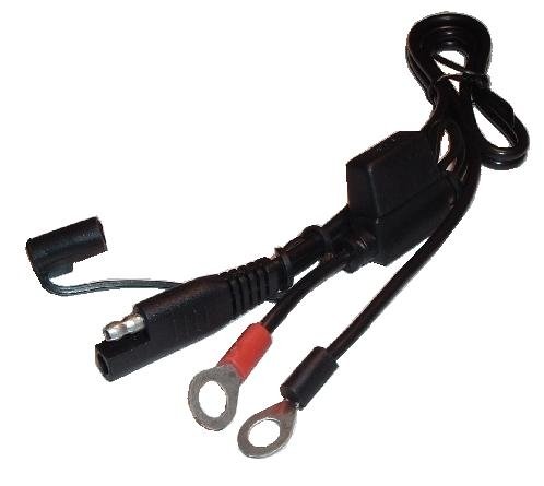

I have been using a jump start battery to power my depth finder and running lights when needed. I mostly day sail so I have little power requirements. I tried using a cigarette plug going into the jump start but that became unreliable. I ended up wiring a two pin trailer connection directly to it. Its a nice simple weatherproof connection. See picture below. I might start using this for my other 12v items, fans spotlight etc..
