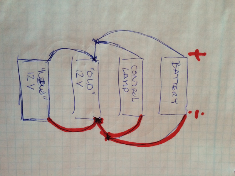

This is the wiring
I think I see the problem. Your NEG is supposed to be black, the POS is supposed to be the red! Sorry, I couldn't resist. I had a three-martini lunch.
Actually, when you plugged into a "hot" outlet, there might have been an arc of electricity that might have zapped something in the charger cord/supply. Like static electricity, so to speak.

I have identified a polarity error In the wiring to first 12V socket In the circuit.
After changing the wiring on this socket there is now the same voltage on all 12V sockets in the curcuit.
I hope this is why the USB charger was blown,
Thanx to everybody for contrubuting to solving the problem and special thanks to Maine Sail for a spot on analysis
