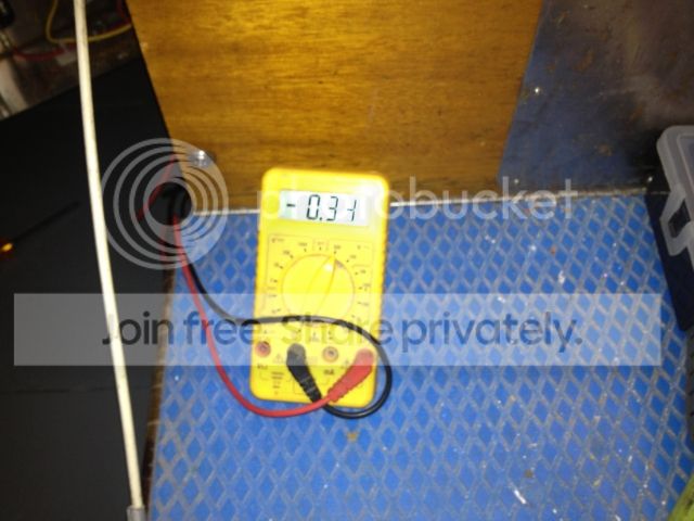

Yes, a couple of things to look for.. 1, a wide voltage capability.. like 10-16 min. volts.. means it has a voltage stabilizer to keep the light output constant with varying volts.. and 2, Look for a color temperature around the 3000 mark for light that is "warm white" and not the cool or cold bluish white.. Look for something around 100 lumens and you'll be happy with the bulbs for interior cabin.. Click on "Automotive LED" on this site : http://www.ledwholesalers.com/store/index.php?act=viewCat&catId=72
Look at dimensions carefully to see if the bulb will fit in existing fixture. Under the "festoon" type bulbs, there is a bulb that goes into the Aqua Signal 25 nav lights.. I am trying one in warm white and note that it is equal to the original Aqua Signal incandescent in color and brightness.. it draws 3 tenths of an ampere ..
