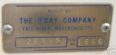

I think O'DAY did have more than one factory at times..... and although I hate to say it....... I have found that the numbers don't always add up, in other words I found another WIDGEON where the difference (between that boat and mine) in the HULL# and the difference in the CLASS# were not the same. Still, it is reasonable safe to use these numbers to figure out age of the boat (I wouldn't worry about being off by 1 year or so). See below for that ID plate from another Widgeon. (H#22655 C#1666)
