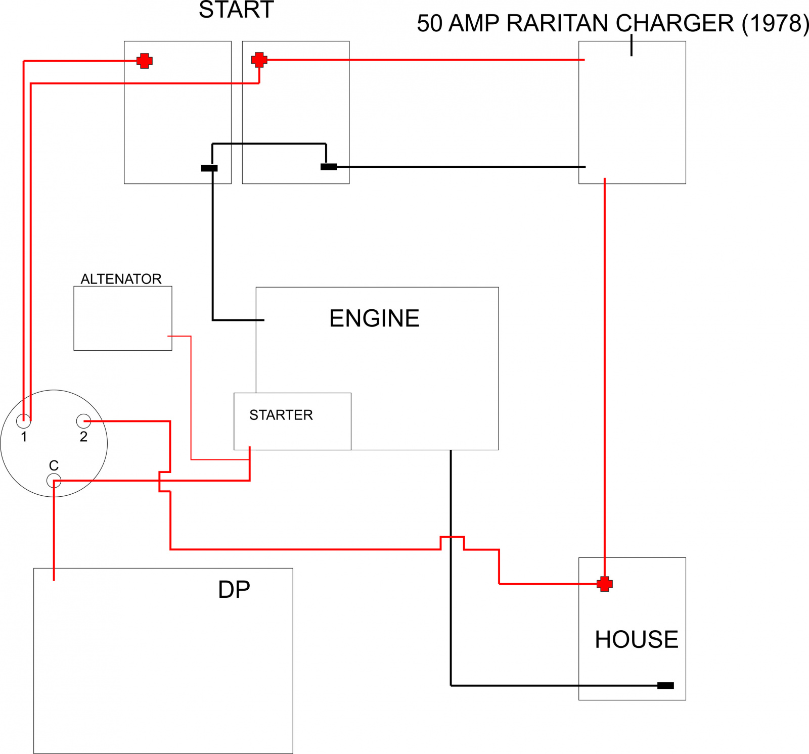

My boat was built in 1980 and has an old Raritan Crown II 50 Amp charger. I finally sat down this weekend and traced all the relevant wiring that i will be replacing first including new charger, house batteries, start batteries, 1-2-B switch and Blue Sea ACR, fuses etc... attached is an image of how it is currently wired. i am curious if firstly, the wiring is typical of how it might have been done in 1980 era and second if everything looks relatively safe even though there are no fuses present.
At first glance my inexperienced eyes tell me the second start battery is probably getting undercharged constantly and im wondering is the alternator sending a charge back to the C post on the switch sending charge to whichever bank i have selected?
The cable leading from the Alt to starter is 10 AWG. All the rest of the wiring looks like 4 and 2 AWG. mostly 2 but the long length (20 ft round trip) to the house is 4 AWG
Yes, possibly. Who knows what may have been done along the way, but nothing strikes me in the diagram as impossible to be original. Only thing that looks odd is the 2 battery start bank vs 1 battery house bank.
You’re definitely going to want some fuses. Hard to be safe without that. There’s nothing providing overcurrent protection for any of the wiring.
The two Start batteries are electrically parallel, so whatever charge one gets the other will too, minus some small losses to resistance in the cables. I wouldn’t worry about that relative to some of the other concerns I’d have with the existing setup...
Yes, exactly.
There are voltage drop calculators that will help you figure out the best gauge based on load and wire length. Look at the loads your panel needs, and charging capacity of your alternator to see if the gauges you have are appropriate.
Now - As for the two battery start bank - that’s pretty unusual. What types of batteries are those, and what is the house battery? Usually you have a big house bank, and a smaller house battery. I’d be a little concerned a previous owner may have swapped the configuration to compensate for other issues starting the engine. In any case, I’d go back to a bigger house bank. The start bank shouldn’t need to be more than a single Group 24 or equivalent.

It appears you have a 36 foot monohull sailboat. Why two start batteries? And only one house? Perhaps reversed?
It has a 36 HP 4 cylinder Universal. I honestly forgot what the cranking amps are required for the engine. It s the way it was setup when i bought the boat and didnt understand enough about electrical at the time to change anything. its worked so far even though the house battery is so small. most of my loads are at a dock and are AC which is wired directly to the panel. no inverter or heavy loads on the DC side yet.
the two start batteries are west marine brand...650 cranking amps each if i remember correctly 85 amp hours each i think. house bank is west marine deep cycle 95 amp hour i beleive? plan on replacing this with two 12V 250 AH Trojans.
i can start the engine with either bank although it is instant 1 sec start on the start bank and a couple seconds on the house battery.

Fusing is essential. A dead short into one of those cables will make for a lot of unpleasantness. Fix this first.
As David noted, the two batteries marked as start are not correctly wired in parallel, nor is the charger correctly wired to the bank.

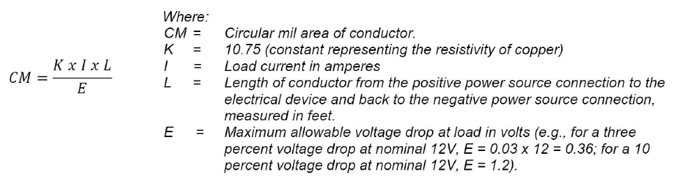

10 AWG from the alternator is too small. The correct size depends on the output capacity of the alternator, and the distance between the alternator and battery bank, including both the leg from the alt to the switch and the switch to the battery bank. You want no more than a 3% voltage drop. If you have a 75A alternator and 20 ft RT to the bank, at 100% output (and 14.4 volts) your voltage drop on 10 AWG is around 21%. Your batteries are only seeing 11.4 volts.
Using the formula below, and the above assumptions, I calculated 44,972 circular mils which equates to just over 4 AWG. So the correct size for that wire is 2 AWG as your system stands now. If you increase the size of your alternator to feed those new, larger batteries, you'll need to increase the wire size.

DP= DC Distribution Panel. I should have been more clear. Good questions i would be interested in the explanantion as well. The 10 AWG wire is no more than 12" length on my setup and in the interest of completeness, and to correct an earlier error...all my battery cable is mainly 2/0 with the long length to the house battery being 1/0. the alternator is stock/original which if im not mistaken is 50 AMP but havn't been able to confirm.
