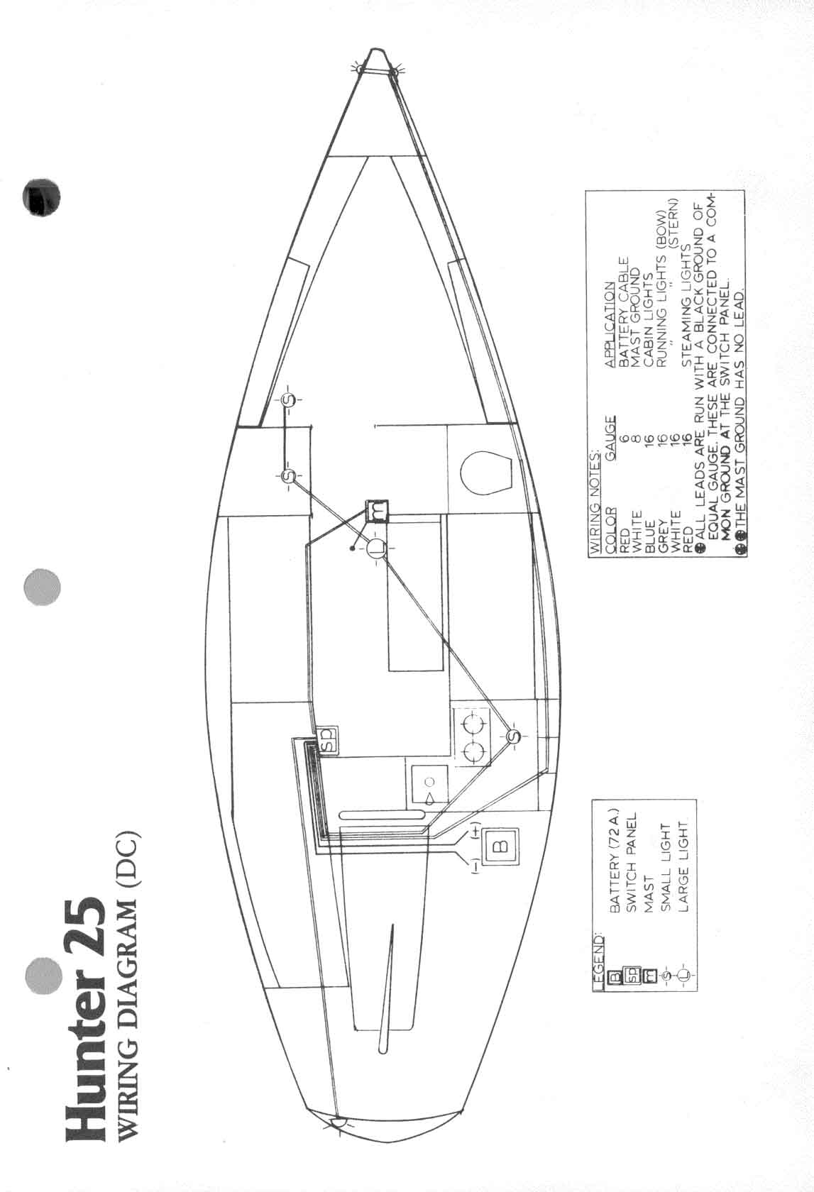

Elec diagram
Steve is correct. get help. Attached is a jpg of the DC wiring diagram from owners manual. You will need to wire your own AC as the boat did not come with AC. a lot to be considered about crimping vice wire nuts, wire type in the corrosive marine environment.... and safety. You may need a biger altenator and additional 'house' batteries with an inverter.
