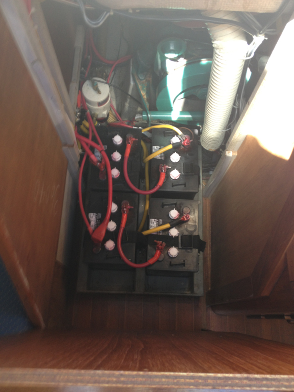

Hi all, I'm looking to upgrade my house bank to 4 6v batteries. I plan to keep a single 12v as a start battery. The problem I'm seeing is space to house all this lead.
What type of setup do you have and how is it positioned?
Currently we have a pair of group 27s under the stairs. The 6v box I'm looking at measures (max) 22 3/8" (L) x 15 1/2" (W) x
12 7/8" (H). Then a box for the 12v too.
Interested how or if others have done this.
Thanks!
SC
Jan 25, 2011
2,439
S2 11.0A Anacortes, WA
4 six volts under the stairs in two banks. I put a 12V start batt under the floor of the cockpit locker. There's a little shelf in there that I think was used for the potable water pump. I put a new diaphram pump on the stringer and a batt box and batt just fits on the little shelf. I wired it into the common of the batt switch through an on/off sw. Not very scientific and things have to be manually managed. And yes my plotter etc reboots on engine starts.....for now

If you two would be willing to post a photo (around the engine compartment and port locker I'd be grateful. I've got the 6v bank situated I think but always look to see if others have better ideas as they often do!

Oh crap. I shouldn't tell you this. I equalized batts this last wknd and everything was pulled out..... I'll try and remember this weekend.....

Thanks Mark! Worked great. I think we will have to find or fabricate something for the locker battery or possibly 2. This is my first project of this type so all advice and pics are appreciated.
