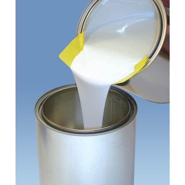

They sale these at most stores (HD, Ace, Lowe's, local hardware) for pouring which will keep lid clean. I always use it for my bottom paint. Easier to clean if want to reuse.
