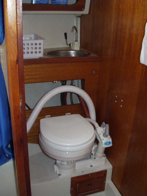

I just installed a JABSCO manual marine head and found that there is a very noticable leak at the discharge elbow hose connection. it is a 1.5" connection and I am using 1.5" heavy duty sanatation hose and it seems to slip on ok, ie, seems to fit, but it leaked. I realigned the hose and tightened the clamp twice to no avail. I put on a second hose clamp and it leaked at the same rate (10 ounces per minuite estimated, a pretty noticable flow, more than a drip anyway). I know I could goop up the connecter and hose with silicone and make it work.... but I shouldn't have to....should I? What's up with this? Leaking is Seattle, JIM

Have you checked to see if the new hose is putting a side load on the discharge fitting? I just installed a new manual Jabsco (and, contrary to what Peggy said, mine had 1.5" discharge)and had a similar problem. Turned out that by playing with the length and bend of the new hose, I could get the drip to stop. Seems that side load on the discharge fitting pinches the Joker valve on one side, causing it to weep on the opposite side. Good luck!

Thanks for your comment Jim. I do believe there is a significant side load (see photo) and the leak came from one particular spot on the hose/fitting innerface (interface?) so I'll go back and see if I can relieve the side load. Peggy suggested the fitting might not be 1-1/2 inches, but I think it is because 1) I measured it, but it was hard to see the exact measurement w/o taking the head out and 2) the hose slipped on easily, but didn't have much, if any "slack" around it, ie, it didn't seem to be a sloppy fit. Anyway...back to the boat for a peak. I really appreciate all the quick help here...on Thanksgiving none the less! JIM

If the Jabsco has much side force, the flange will not seat properly and it will weep. Known from a lot of experience. As to the discharge size, easy to check but check the side load first. Good luck, Rick D.
