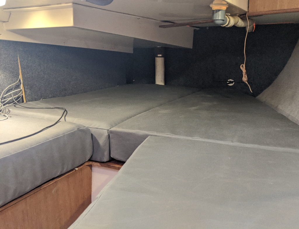

It's been awhile since I started this one thread but finally got around to it. over last week the weather has been awful in southeast PA and North East Maryland
First Cuts were ragged because they were exploratory turns out it was good. We took the time to do it that way because of the closeness of the tank wires to and from the battery, battery charger, refrigerant lines all attached to the back of the bulkhead.
I was surprised to determine the fuel tank is nearly 20" tall!
Need to get a aluminum access plate for cutting into the tank there's plenty of small things to do before splashtime
The fuel in the Racor turn black over the winter so I guess we're going to have to do something pretty soon with that

Well it took a year to finally get it done in case you didn't see my other thread we did clean the tank and put an access plate in it
The most difficult part was finding a fabric that I liked and I ultimately used Permatex spray adhesive I did not use 3M 2400 because of the cost I'm very happy with this I wrapped the fabric around the edges I may or may not put trim pieces around and in the corners I do have it right now I'm tired from crawling around in there I'm pleased
