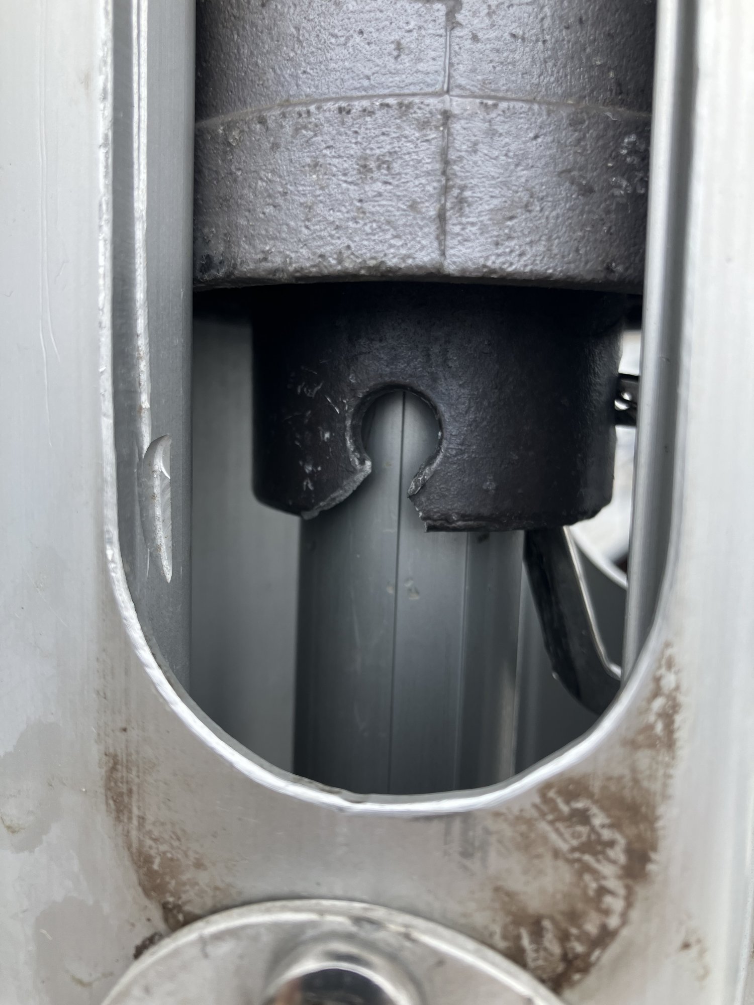

The rigger arrived late this morning and he swapped out the 1/4" line for my topping lift for a stouter line, then sent up his (120 lb?) helper to retrieve the swivel on the main halyard.
What we discovered is the cast iron hole in the swivel into which the clip for the head of the sail had lived was broken. Thus, the clip with the seizing wire intact was still on the head of the sail when I removed the sail:

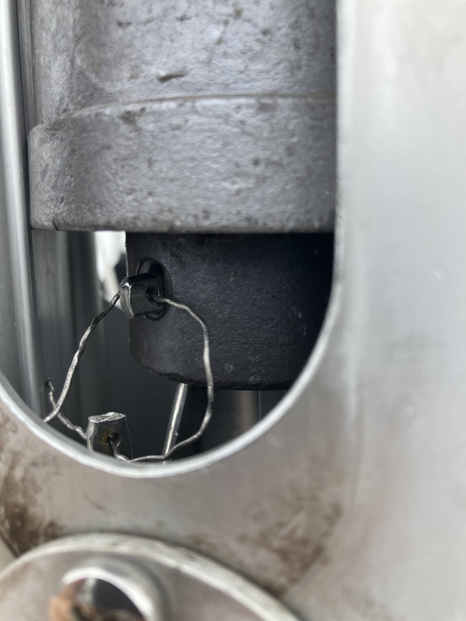

Then we realized the PO hadn't been using the correct attachment point on the swivel. The correct hole has additional reinforcement you can discern at the top of the clip:
