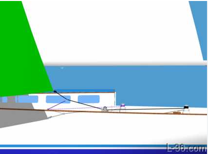

From the rest of the responses about changing twist when sheeted way out there, I wonder if a trick from the Code Zero sphere would work? We sheet the C0 way back near the pushpit because that is where we have outside blocks but that ends up being too twisted so we use a twing down to a stanchion up near the primary winch location and pull down on the sheet from that location till we get the desired twist.
This is the idea but mounted for jib
