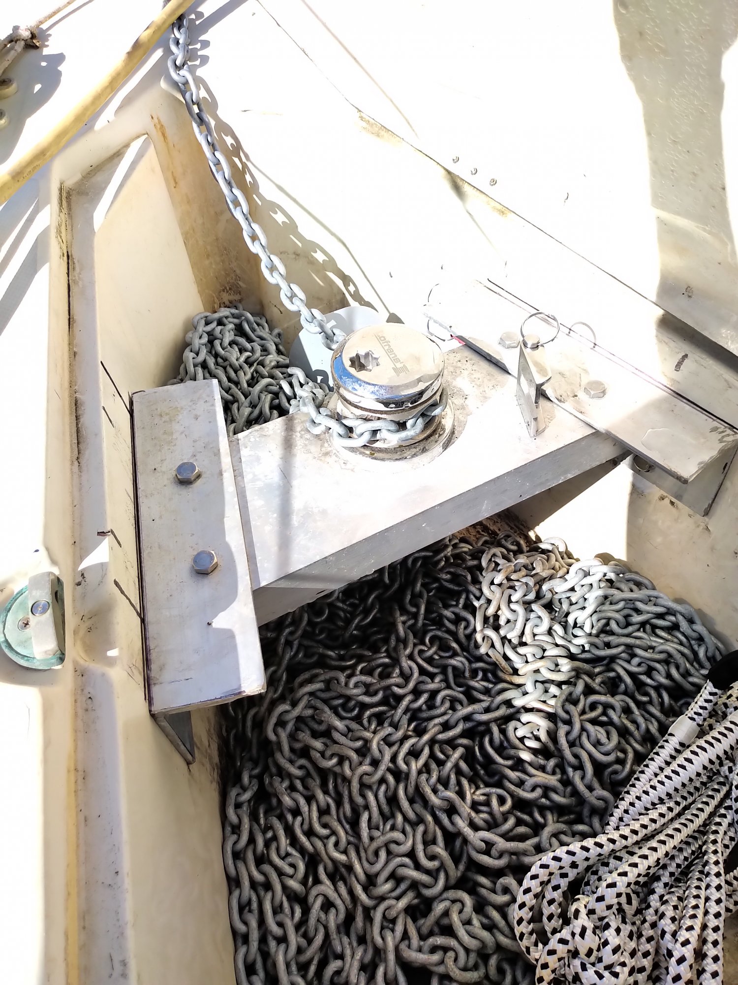

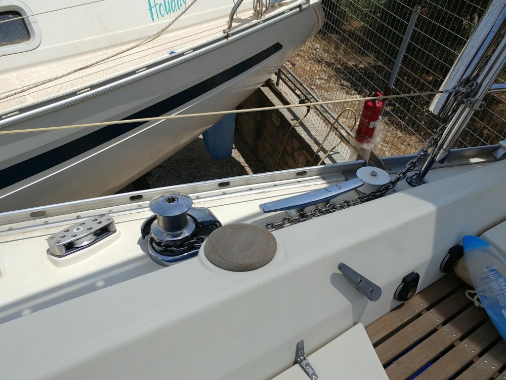

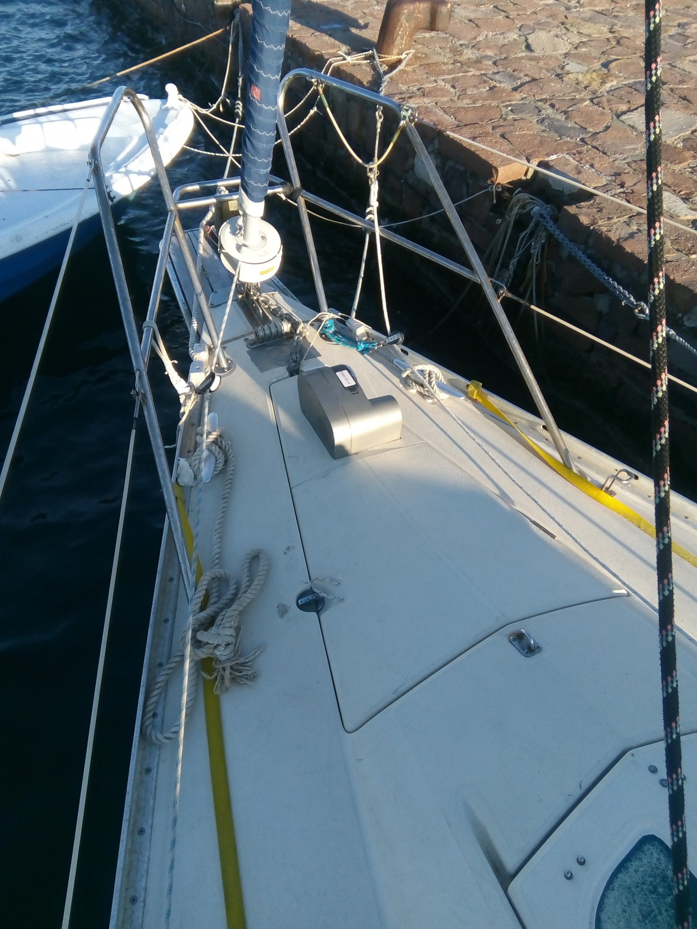

Here are my bow anchor windlass - Lofrans Project 1000 and my kedge anchor windlass Quick Crystal pics.
The chain for the bow anchor windlass goes down a large and long SS pipe under the V-Berth where there is also a whale pump that pumps out water where the fuel tank was and is now the chain locker. The boat has two newer custom 90L tanks under each settee. 70m 8mm chain.
The chain for the kedge anchor windlass goes down a short and smaller SS pipe and a tray into the cordoned off aft section of the cockpit locker. 40m 8mm chain.

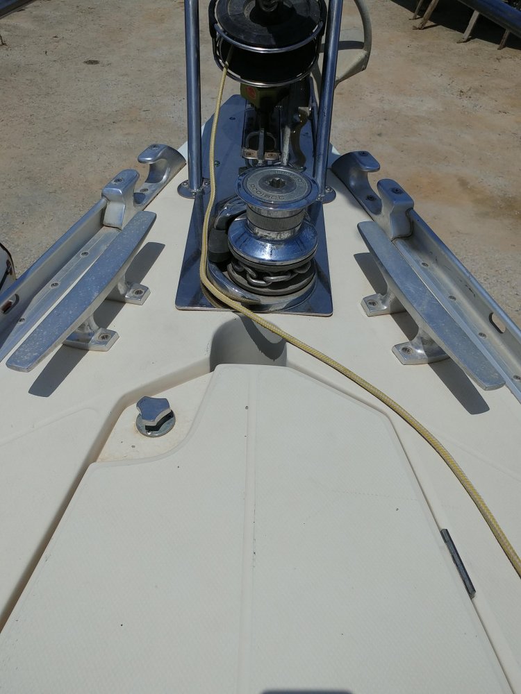

Lofrans SX1 with 250' of 1/4" HT chain, currently with the standard Yamaha danforth-type anchor and bow roller. The motor for this model of windlass is in a waterproof housing. Up and down foot switches are out of view to the left of this photo. Due to the standard anchor and roller, I have to stow the anchor on the roller by hand. I also have to knock the pile of chain over a few times as it cascades into the locker. But it's night and day compared to hauling chain and rode up by hand.

I see you have upgraded your windlass, anchor and rode. That should be a good feature for the coming season.
Way to dive in to the archives and share your improvements over 2015.
