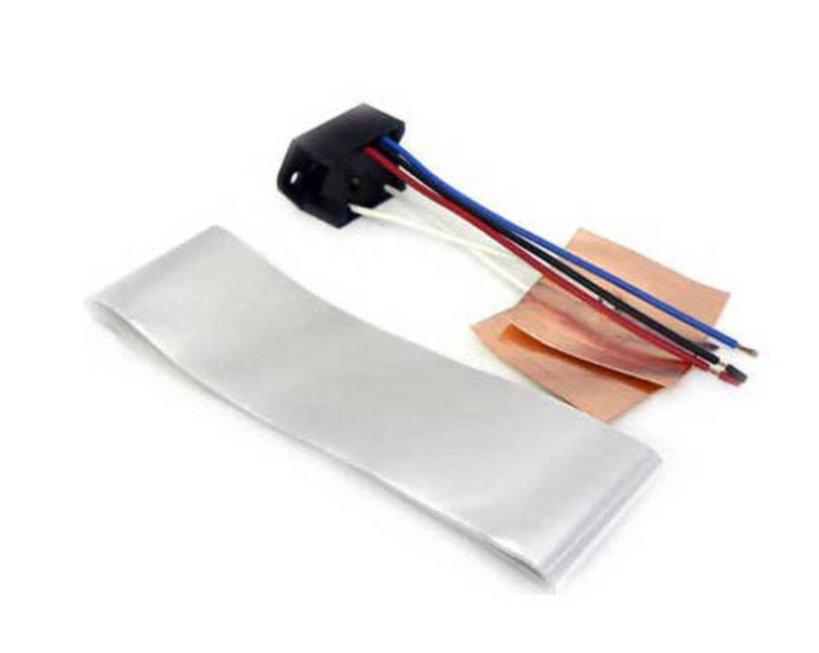

Assuming the sensor has a moving float within the tank, it's pretty well doomed to failure because of the tank contents :poop::poop::poop: . The only thing of reasonable cost that works in a holding tank will be a sensor and gauge which uses exterior aluminum strips to sense a change in electrical properties such as SCAD Technologies :
The same technology can also be applied to tank internal tubes but all sensors are sealed within the tube.

Wema tank level gauges work just fine in water and fuel, but like all tank level systems that use internal sensors they aren't great for waste because waste contains animal fats that build up on the sensors, requiring hands-on cleaning with a scrub brush and detergent in a bucket when you see that you're no longer getting accurate readings...not a pleasant job. Which is why more and more people are switching to systems that use sensors that are applied to the outside of the tank (any material except metal and they have a sensor for metal tanks that never comes in contact with the contents).. SCAD is the top rated system Scad Tank Monitors available both single ("solo") and two tank systems, allowing you to monitor two holding tanks or a holding tank and water or gray water tank on the same panel for a very reasonable price and provides infinite contents levels instead of the typical 1/4, half, 3/4 and full readings.. Available from a number of retailers that even include Amazon. SCAD's tech support is excellent too.

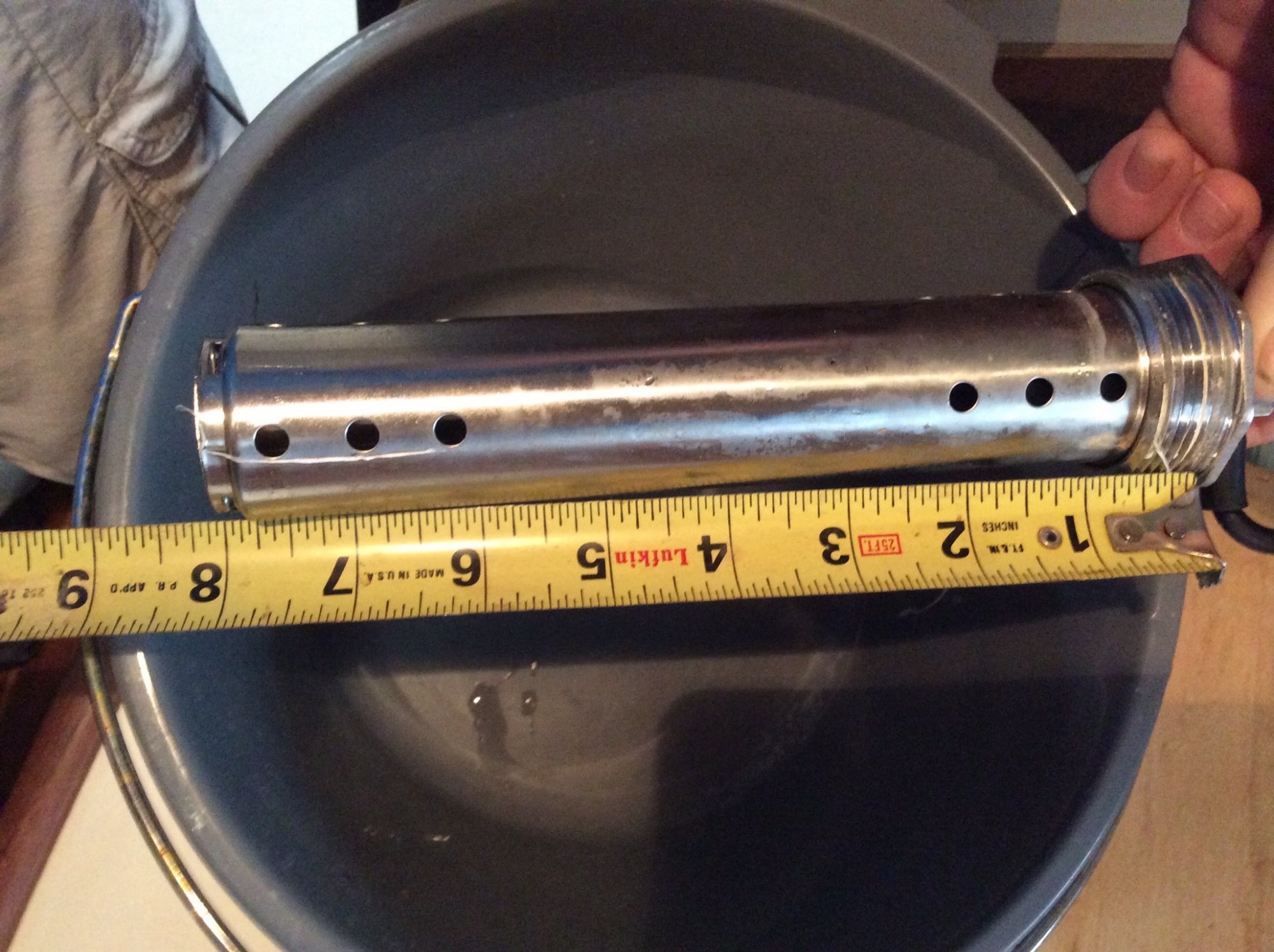

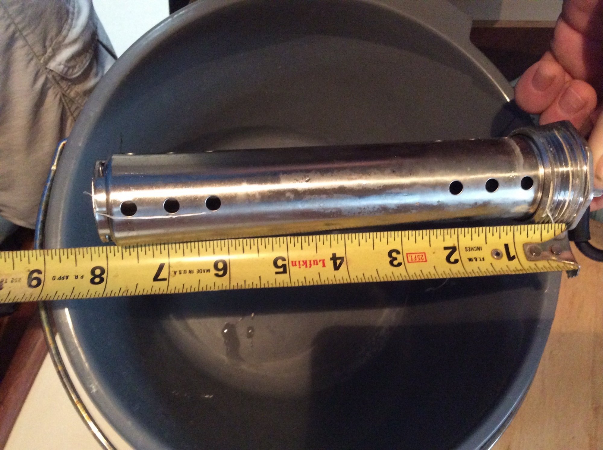

Sorry to object again Peggie, but not true for Wema Waste Tank Sensors.
Here is a picture of mine that does NOT need sensors like you discribed.
My hold tank is 10 inches deep, thus the 8 inch Wema.
My Tank slopes to a low spot for it Macerator Suction Pick up.
Hope this Helps
Jim...
