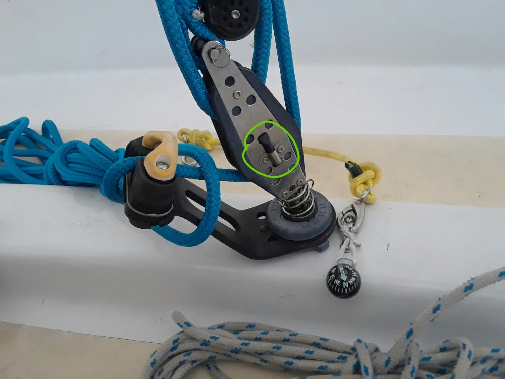

About locking mainsheet sheets...dont.
Check the bottom set of purchases for the main. Mine ratchet. There is a peg that slides from ratchet on to rachet off. Make sure the purchase is going the right direction so you are not racheting the release of the main. Did that....it gets really difficult to pull in the sheet when working against the rachet.

I used the pulling in on the main and that is how I got through a few tacks. Which led me to think about the end sheeting. But I agree it didn’t add that much speed and if I was a speed junkie I wouldn’t have a 170 I guess. Something with a weighted keel and long at the waterline. Lol
I check you were right my purchase was backwards I would hear the ratchet sound as I let it out. So I think I was pulling against the locking mechanism. Duh. I will switch it around and see how everything goes.
It should make the ratchet sound as I pull in correct?
Thanks
Apr 16, 2017
841
Federation NCC-1701 Riverside
Thanks
Yep. Pull in and it should click. There should be resistance hold the boom from going out as the one purchase only spins one way. Slide the peg and all purchases spin freely.
Ratchet off for light winds and packing up.
