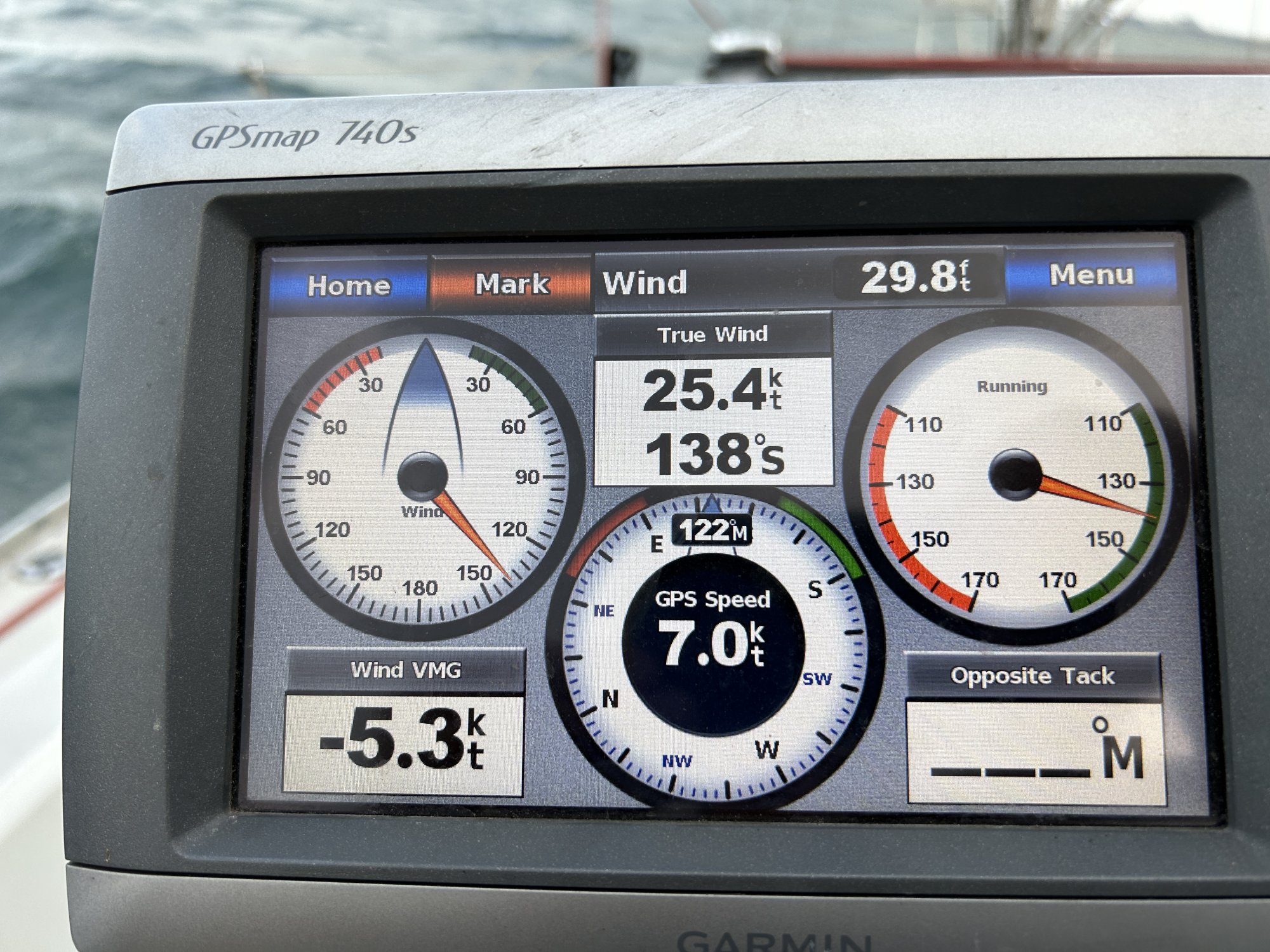

Or get a chart plotter that can do GPS speed and depth (still need a transducer installed) and display it all on your CP.
This the approach I took with my setup.
