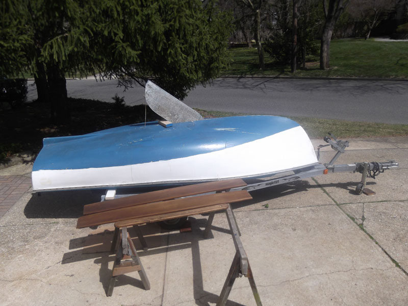

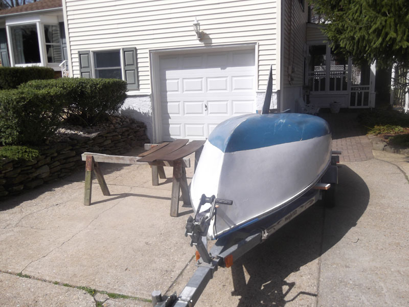

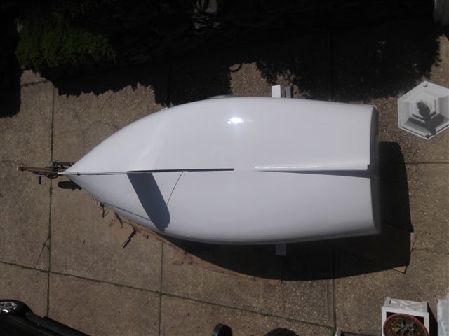

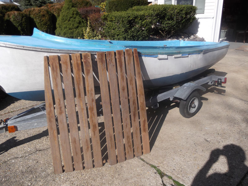

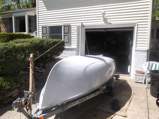

I've started restoration on a "SKIMMAR", a 12' sloop made in Ct., probably in the 1970's.
I'm unable to access the centerboard pin since no bolt or nut is visible in the cockpit. It's a double hulled boat.
Possible options:
1. Try to locate the location of the pin from below, then cut access ports, one on either side, to replace the bolt. If the hull is double at the trunk, I'd need to install 2 ports on either side to make the trunk water tight.
2. Cut off the top of the trunk to "take a look" and later replace it with a wooden cap. This will give me a look at the board and may allow me to bang the board loose but won't provide direct access to the pin.
3. Cut the whole centerboard trunk off at the bottom of the trunk...fix the problem... then figure out how to re-attach the trunk. I'm not thrilled with this thought.
What do you think?
I also have questions about the sailing characteristics of the boat and the bench seat measurements (Should I follow the hull contour on the side of the seat closest to the center line, or run the seat in a straight line from the rear support to the forward support?). If I follow the contour there will be only an 8" bench, which may be too narrow to be comfortable.
I've sailed many small boats and restored a few, but have never seen a "SKIMMAR" until I found this one. I'll be glad to call you if you'll provide a phone # in your reply.
