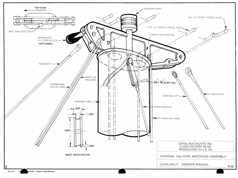

Here's a diagram of my 1977's masthead. Note the width of the sheave's groove. Compare the diagram with your new sheaves.
They are narrow, because back in the day it was common to use wire to rope halyards. Catalina 27's came equipped with 1/8" wire to 3/8 rope. You should know what you have ahead of time. Especially if you are planning to change out the halyards. That could also be reason you're having difficulty with them.. all rope can get wet and old and swell up... getting pinched rolling over the top of the sheaves.

Thanks for the great info, Joe. The diagram is especially helpful.
Both my main and jib halyards are 5/16 rope which I think is the right diameter. The jib halyard moves freely over the sheave but the main creaks and groans as it makes its way up the mast and the weight of the sail increases.

Measure the new sheaves that you already have. Just the width across the channel. If you have some 5/16 handy, see how it runs in the groove. My halyards are 5/16 with core AND cover, but the part that goes over the top sheaves is core only, and that is 3/16. Thats how I accommodated the 1/4" limitation of the original sheaves. Most people will say it's okay if the rope rides up a little.. the clearance is so tight it is unlikely the rope would pop off and get jammed. Especially since so many people have roller furling and don't really use their jib halyards that much.
