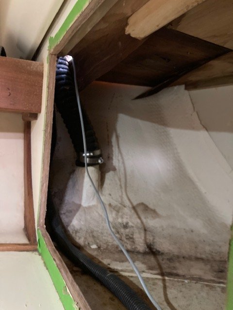

Thanks, but I really don't need any parts. What I'm looking for is how to access the exhaust hose where it discharges outside the hull. It appears that the only way to access it is either down through the deck the batteries are sitting on (not too easy for a 70-year-old guy with a bad back) or to cut out a section of the aft cabin bulkhead. You can just see it in the attached pic.

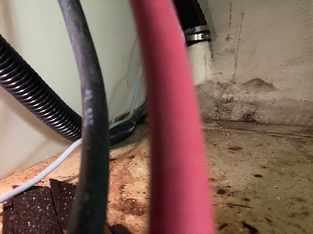

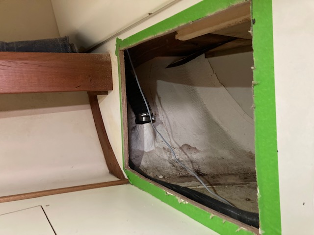

I finished replacing the hose yesterday and what a PITA! I had to cut a 14" by 18" hole in the aft cabin bulkhead in order to access the point where the hose exits the boat. And after getting the old one out (cut it in half) I had to open up the holes where the hose went through the battery deck in order to get the new hose to align enough to slip onto the exit (you can see the bend in the original one in the picture). Also enlarged the one in the battery deck so I could feed it through back into the engine bay. Somehow though, in all the pushing, pulling and cursing I managed to kill the power leading to the instrument panel. Oh well, something for tomorrow.....
