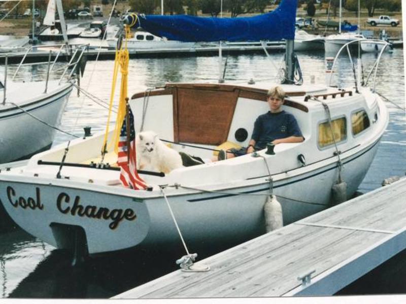

I once owned a Coronado 25. The Coronado 25 had a false transom (motor well). That really seems to me to be the best set of compromises. The fuel tank was stored in the motor well also, so... no fumes in the boat... when the motor was in the down position, the prop was well enough forward that it would have been really hard to bring it out of the water... and the motor was protected from following seas.
I just grabbed this image off of the internet so it is not my boat, but you can see the protected motor well here...
