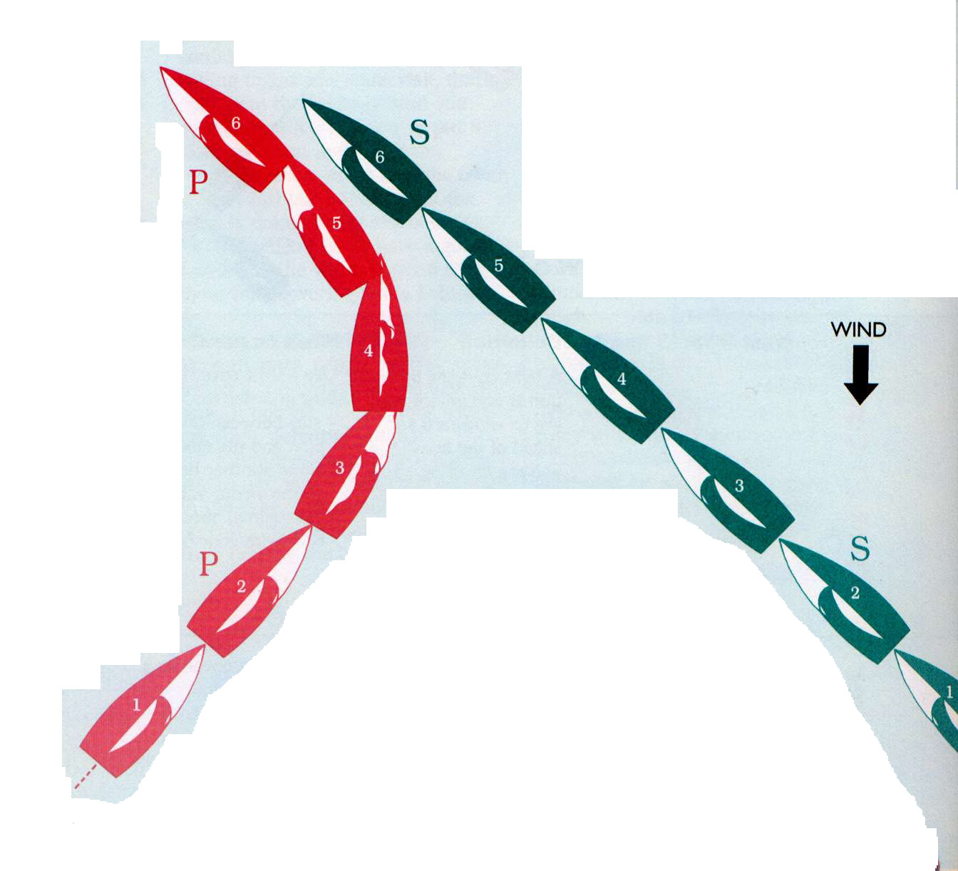

If you are on the starboard layline (or very close) and a port boat tacks just to leeward of you and stays just ahead, you have been leebowed. You're pinned. The wind bending off his sails turns back toward you, slowing it and giving you a knock. It is VERY hard to pass a a boat that does this to you unless you are a faster design. In one design, no way.
Lee bow. In this picture, YOU are starboard. Port lee-bows you.
So you both sail this way to the mark, him now the ROW boat as he is leeward (rules 11-12)
Once you get within three of his boat-lengths to the mark, rule 18 (mark room) comes into effect. As an inside boat with overlap (or clear ahead), he is entitled to mark room; room to make a seamanlike turn around the mark. You HAVE to give him room.
Note he has to be able to mark the mark to do this. He CANNOT tack in the zone, as he looses all rights. Often you will see a boat 'shoot the mark', luffing at the last minute in an effort to make the mark. Anyone near hates this guy.
