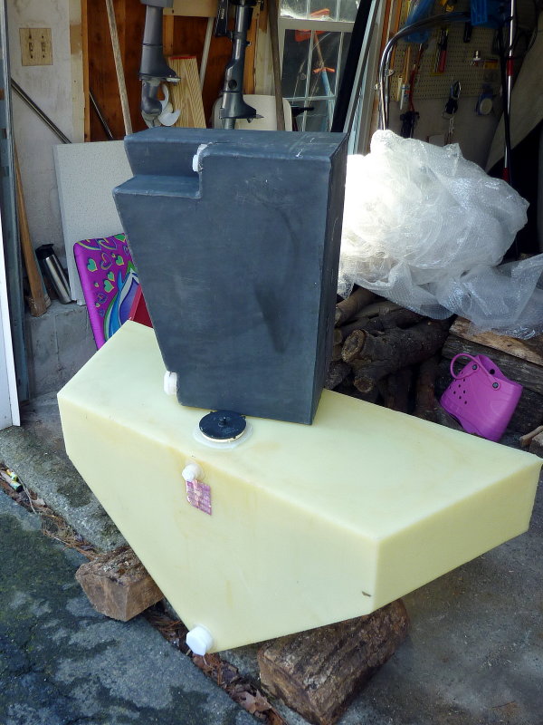

It's the only one I've seen too.. Usually a "bleach submersion" or just a "foaming bleach" wash down, takes care of any externally attached odors but the Ericson tank seemed to be "embedded" in the raw material.
The tank had a rough suede look to it, rather than smooth, and that made me question the resin mix...? I always plug tanks and have a nice collection of plastic NPT plugs just for that purpose...
The top black tank in this image was the Ericson tank. In this photo both tanks are being internally bleached sanitized and they are plugged at all openings.
Normally this works incredibly well and it's end of story. The bottom tank had zero odors in less than a 36 hour soak and just an exterior bleach spray down (did not even require any PureAyre)..
The top tank never survived even when the whole tank, not just inside, was submerged in a bleach bath for multiple weeks. Again, that black tank is the ONLY sanitation tank I have ever seen that seemed to "odor permeate"... I have seen plastic diesel tanks odor permeate but not sanitation, other than this one.
