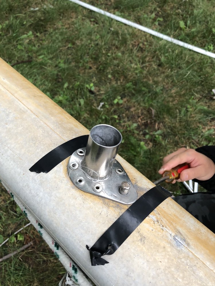

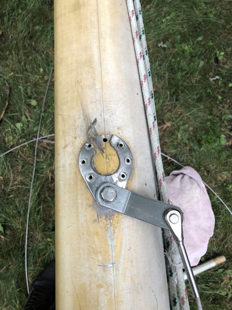

Hello all,
I recently purchased an O'Day 25. The spreader base which is attached to the mast has snapped off. The spreader base is attached to the mast via pressure tubes and a large bolt. While I have removed the nut behind the bolt I have not been able to remove the bolt or the spreader base. Can anybody share some insight as to how I can remove and replace the spreader base and bolt holding it in?
I Believe I have found the right size spreader base but can anyone confirm this for me? ( http://www.rigrite.com/Spars/Kenyon_Spars/Kenyon_Spreaders/SPR9H-Round.php)
Thank you all.

It looks like you've been bashing that bolt, on the thread end - is that so? You should put a block of aluminum or even hardwood on it if you do.
Can you turn it with a wrench?
It may be frozen to the aluminum mast, due to electrolytic corrosion. It can almost be like they are welded together. Not sure what will dissolve that.
Hey,
So I can turn it with a wrench but I can't pop the bolt loose. Thanks for the suggestion because I have been destroying the bolt attempting to remove it with a hammer.

It is likely that inside the mast the bolt passes through a piece of aluminum tubing that is there to prevent the mast collapsing, i.e., being squished, when the bolt is tightened. I suspect now that this piece of aluminum is corroded to the bolt, and that's what's stopping it from coming out.
If you can get those brackets off, on both sides, by drilling out the rivets you will probably find that the hole in the mast on one side is big enough for the tube to go through, and is stopped by the bracket, and that the other side the hole is only big enough for the bolt. This is how it was on my Catalina 36.
If that's it, you may have to carefully hacksaw off the head of the bolt.

Great advice! After removing the other side with a drill carefully (bases are $140 ea!) I could see the aluminum tube holding the bolt. I’m going to see if a week of PB blaster does the trick to loosen it up before sawing off the bolt head and removing the aluminum tubing. Thanks again!
