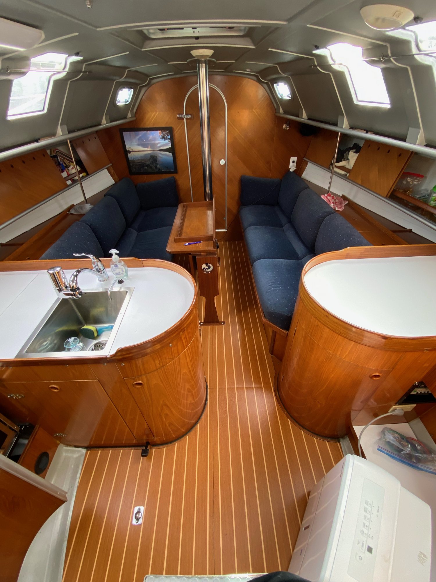

Beautiful! What boat is this?I would avoid any sort of carpet. You could paint the floor with a non-aggressive non skid...
If you don't mind a bit spendy, we are happy with our Lonseal 'teak & holly' heavy duty vinyl. Epoxy down, never needs maintenance, and looks like the 'real thing'..View attachment 215334
awesome job.If you like doing this sort of thing it's great fun. .

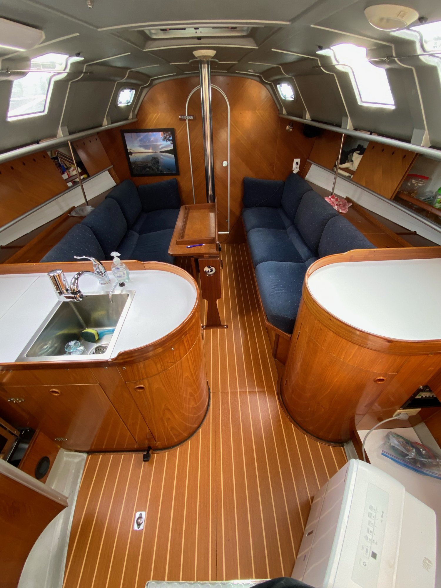

Thanks! She's a 1991 Beneteau First 35s5. We've just finished a total interior refit.Beautiful! What boat is this?

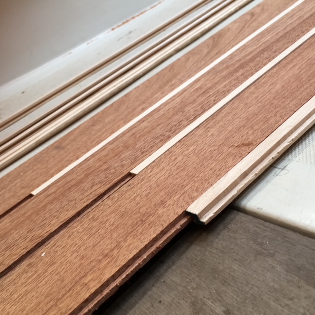

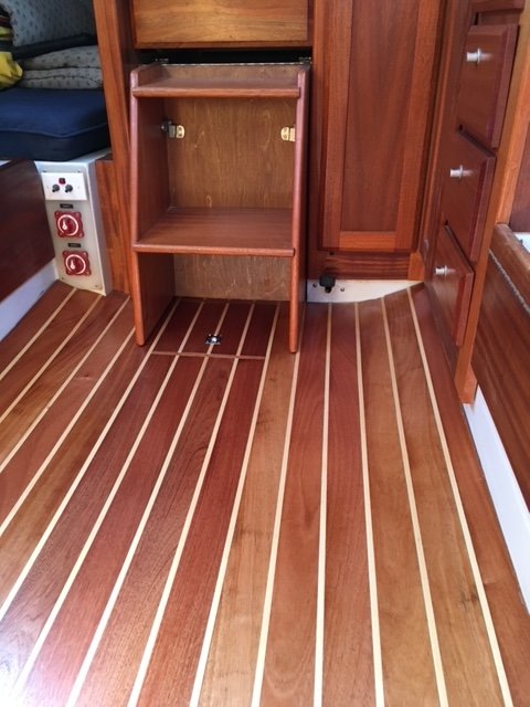

Wow, beautiful!I milled some mahogany and maple into T&G boards and glued them to the cabin floor of my 1976 Ericson 27. If you like doing this sort of thing it's great fun. I think the Lonseal Teak and Holly is a really good way to go.
That looks great!I would avoid any sort of carpet. You could paint the floor with a non-aggressive non skid...
nice!!! Enjoy!Thanks! She's a 1991 Beneteau First 35s5. We've just finished a total interior refit.
a lot of people are using the black teak calking methodThe problem with the EVO panels is the gap between planks.. I think that would trap a lot of dirt etc.
This could be a good solution for now actually@xavpil
non-skid throw rugs. They don't slip, feel good on the feet and when they're dirty put them in the washing machine.

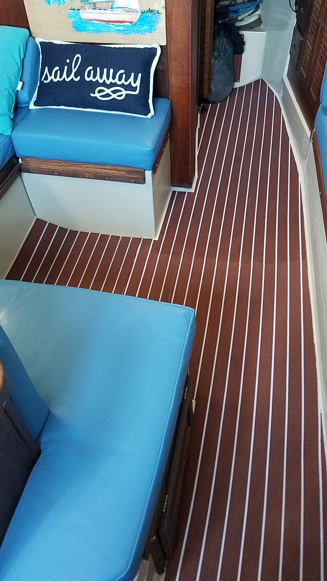

EVO can be tricky, and like anything else it is all in the preparation. We went with EVO 4 years ago, and it is doing well. It can show rings if a part of it gets wet, but re-wetting and drying usually takes care of it. Getting the alignment of the lines correct on the first piece is critical, as everything else will build from there. We made templates from paper drop cloth and cut it out oversized at home where we could lay it out. (A bit of a pain, as it arrived tightly rolled into a tube and the backing slipped on several pieces.) Cleaned sole with acetone, laid foam down, rolled it to adhere well (Don't skip this step!), and trimmed to final size. Repeat until the sole is complete. We did the head and quarter berth as well. Cut 'teak' strips from scrap and used for non-slip on the companionway ladder.What options did you guys pick?

great result!!!EVO can be tricky, and like anything else it is all in the preparation. We went with EVO 4 years ago, and it is doing well. It can show rings if a part of it gets wet, but re-wetting and drying usually takes care of it. Getting the alignment of the lines correct on the first piece is critical, as everything else will build from there. We made templates from paper drop cloth and cut it out oversized at home where we could lay it out. (A bit of a pain, as it arrived tightly rolled into a tube and the backing slipped on several pieces.) Cleaned sole with acetone, laid foam down, rolled it to adhere well (Don't skip this step!), and trimmed to final size. Repeat until the sole is complete. We did the head and quarter berth as well. Cut 'teak' strips from scrap and used for non-slip on the companionway ladder.
