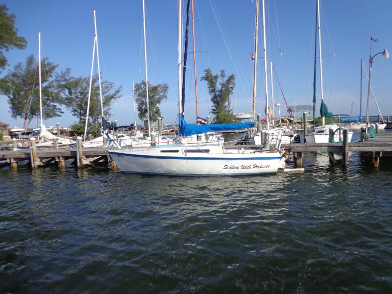

I have been sailing my current boat for 3 years now. I have a 9.9hp 2 stroke engine. According to the GPS I can make 7.7 Knots into the wind at full throttle. I use lots and lots of fuel at this speed. I have never had the need to use all of the power. I have learned that my 52lb thrust electric will move the boat against a 20mph wind against the tide in a channel. I just need to drag the boat backward so the tall bow does not catch the wind and turn me around. I keep the electric for emergencies like having the return spring brake on the main engine when coming into the channel against the tide at the end of a very hot day(You can see the electric in the picture after it was used to get to the loading dock. The main engine lost the return spring and I was leaving that day. It got me to the dock the day before and then to the loading dock.).
