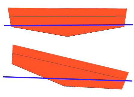

OK, so this is for everyone but Dave. ;^)
When about boat (in particular a flat bottomed boat like the 170) is sitting flat on the water is has max wetted surface area, and max parasitic drag. A large bottom area drawing 1-2 inches of water. But when a boat starts to heel, now the reserve buoyancy in the now-submerged bilge/hull provides the required displacement with more draft (4-6) inches, but in a much smaller area as the same number of square feet are providing buoyancy. See this pic of a 170, the entire port side of the bottom is out of the water, the buoyancy for displacement being provided by a much wetted smaller area on starboard. Other factors might effect the particular boats optimal ability, but this point is a universal truth.
Looks like this.

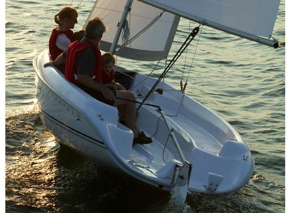

LOL. Where did you get this picture from? The starboard stays look like there is no tension at all and the vang is a cantenary with no tension, even though the mainsail is pulled almost all the way out. Who's watching the the mainsheet, causr the skippers not.
Theres 4 people on the port and its still heeled. The wife is holding on to the youngest child like a human shield.
The water looks calm though for heel. Are they starting a tack to port?

I don’t understand anything about what your question is. What point are you trying to make ?
The starboard stay is going to slack when on port tack is typical. So is the Vang being loose when the Mainsail is under mainsheet tension going up wind. As for the crew position and the lack of wind on the water, who knows. I think it’s a hunter promotional shot
Ya know...
My leward stays did slack a little when I healed up, but they did not slack as much as is shown in the picture that you posted. Perhaps my stays are too tight? Perhaps that is why I have such a hard time getting the pin into the bottom of my jib when I'm putting the rig up????
Does anyone know how tight those things are supposed to be?

If you have the stays adjusted like that picture you should have no problem pinning the jib. You'll have fun trying different things out.
I think youl find it unnerving with the mast wobbling with loose stays. It may become difficult to use the jib furler, and pointing upwind might not be that great.
Google johnson marine dingy stay adjusters. Ronstan makes less expensive ones, i have 4 adjusters. Even with three people it was a pain to have one person push the mast, one person to put the pin in and another to pull the jib to the drum and line up the hole. Looked unprofessional at the boat ramp and in front of my children.
With the adjusters wide open youll have about 4 inches of jib slack. Onnce pinned the mast wobbles several degrees but is controlled . Once tighened there is no slack anywhere. I took out the boat two weeks ago with the cool north Irma winds. We had a good heel going upwind and askef my son to grab the lee stays. Loose, but not slacked.
The manual doesnt have any guidance. I read the 216 manual instead. For the 216 tighten the top stays till the mast is swept back a couple inches. Tighten the mid stays just tight enough to prevent movement. I tried that in the 170 while culdesac sailing. The stay adjuster started to buckle at the chainplate and the adjuster lever was like a loaded weapon. They bite if you dont release under full control. If you get the adjysters i suggest a setting so that its a pleasure to use. A child should feel safe helping you. You're just trying to keep the jib stay tight and the rig centered. I dont think we need to be mucking around with mast rake.
That picture showed a fools rig. That kind of slop in the stays is asking for trouble as rig momentum yanks the pins and rivets.
My point: The setup and sailing techniques are unrefined. People mock hunter boats, and if this is their marketing material, they deserve that kind of industry scorn.
I disagree with your use of vang. The mainsheet has one job, control the boom from starboard to port and back. There is no traveler on a 170.
When sailing upwind the boom is close to center, however, as you indicated, the mainsheet is pulling the boom to the floor more than the center. This is very tiring even with the rachet clicking. At this point you have no control of the sail shape as the leech is being adjusted with each mainsheet adjustment.
The vang is fantastic. Get the boom close to where it should be for the point of sail, then, tighten the vang. Sail a little distance micomanaging the low telltale. Then, watch the top mainsail telltale (i have one just past the deepest draft where turbulace starts to set in). If thats flopping around then tighten vang some more. Even under heavy wind, in that scenerio the vang is absorbing the boom upward pull and the mainsheet is just holdong the boom at the correct angle to the wind. There is a point where a traveler here would be ideal, but the 170 close hauls nicly even though id like the boom closer to center.
Before a major change in heading or wind source loosen the vang.
