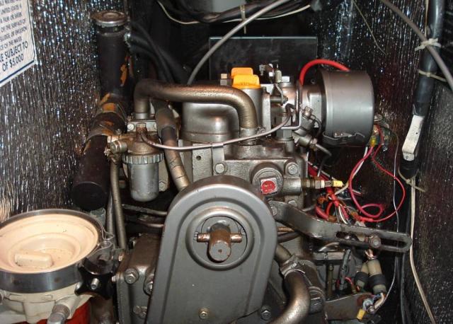

Are you saying your engine is not set up for hand cranking? My old 2QM20 had the hardware but I don't know anyone ever being successful hand starting. You can see the chain-drive to the crankshaft in the photo.

My YSB 12 similar to Ed's 2GM had the setup. I tried on several occasions but never figure how you were supposed to spin the engine with the crank and keep the compression release down. The arc of the crank took it right where your other arm would need to be control the compression release. Suffice to say despite the attempts I never even got a single pop and that was on a very small 1 cyl engine can't imagine trying to get something bigger spinning fast enough that it would fire.
