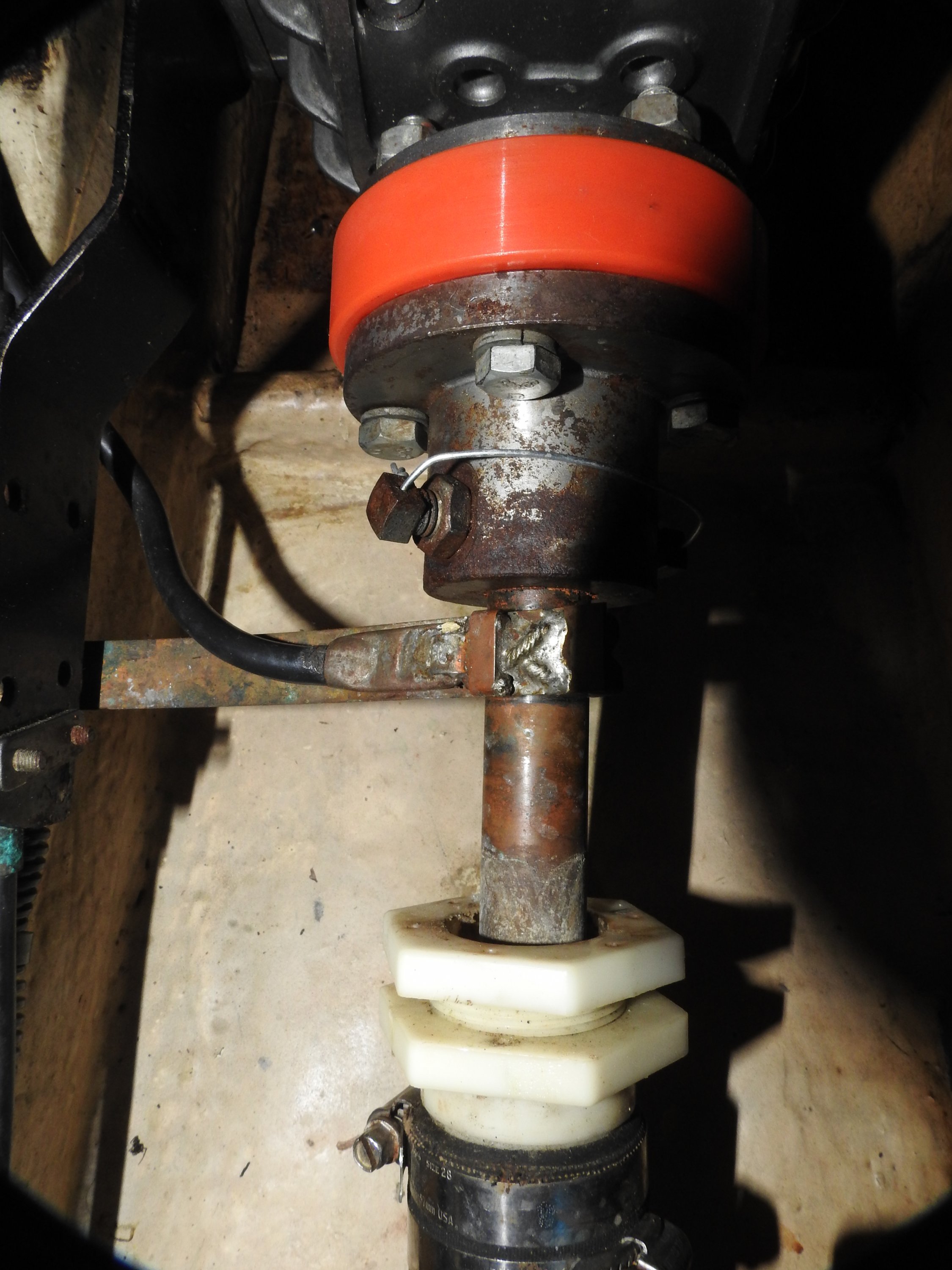

I've about decided to stick with a stuffing box but I don't like my plastic version and I think I should replace the hose. So I'm almost resolved to disconnect the coupler so I can slide everything off and slide a new bronze Buck Algonquin packing box on.

The nylon stuffing boxes are fine. It should have a cotter pin connecting the outer nut to the inner to keep it from backing off. There should be holes for that purpose. Bertram used those nylon stuffing boxes in their sportfishing boats that were considered very good boats.
8,404
I'll bet they intend for those two nuts to be safety-wired together not pinned. What is the likelihood that holes would line up for a cotter pin when the nut is adjusted correctly? Mine has neither which is another concern
