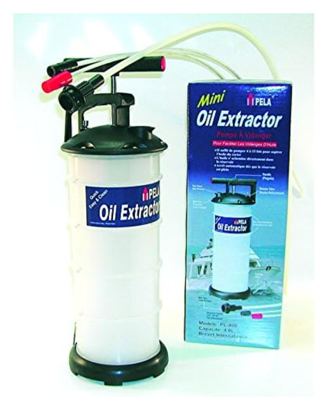

I check my fuel tank every other year (or worse) for water and settlement by pulling a sample from a testing port I installed in the top of the tank using a Pela oil extractor :
The sealant is Permatex #2 which is the only thing that sticks to polyethylene.
The suction tubing on the Pela suction pump has a 12" long clear section of vinyl tubing in it so I can watch the fuel slowly go by on its way to the Pela storage tank.
This is all you require for a check of fuel quality as your fuel changes over every year or so.
