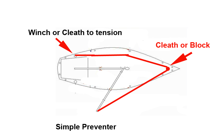

..... A classic preventer is attached to the boat near the bow. Once tensioned it will not allow the boom to swing any significant ammount at all.
I run my two preventer lines to the bow like above and in that situation they recommend having the line attach as far out on the boom as practical as shown above. I use the bail for the mainsheet. Not optimal but still past the mid-point of the boom and it has worked well and is easy to access as far as putting the lines on or off,

Bud, correct about what I am planning and thanks for that diagram, makes it easy to see how you would get rid of any swing - and the shock loads associated with the swing. Im still inclined to just do the very simple thing I mentioned as it addresses the actual problem I did have dealing with the whisker pole but I have to accept a compromise for not having all that extra rigging. I also like the vang idea for its simplicity and you can see in the picture that it would limit the swing to a pretty small angle. The one danger I would still have is someone getting clocked while standing high going into the companionway. Plus a fairly big shock load. If you are standing inside the cabin or sitting in the cockpit.. not a safety issue. In the picture you can see where I had my issue. I was coming back on the left side of the picture after removing the whisker pole, boom swung around from where it was to the side I was on.

I can't take credit for the diagram. If I had drawn it I wouldn't have spelled "cleat" with an "h".

Regarding preventers.... if you find the use of a preventer necessary on a regular basis... (I rarely use one when daysailing) then it would be very simple to rig one up permanently without having to mess with the vang or other specialized hardware. Here goes: Establish an attachment point on the boom with a strip of webbing. Attach two lines to this point... one for each side... run each line forward to a small block located ahead of the mast near the toe rail... the lines then double back to a conveniently placed cleat. There is no need for purchase. Nylon line can be use to provide shock absorption. The lines are left attached... only employed when needed....otherwise left slack when sailing so boom can move naturally. When you bear off on a broad reach or run and the seas are bumpy you may want to apply the preventer... simply grab the appropriate line and cleat it.... voila ! you're good.

From your discription it sounds like your preventer is attached on the combing by the cockpit. If you move the attachment forward this effect becomes less. A classic preventer is attached to the boat near the bow. Once tensioned it will not allow the boom to swing any significant ammount at all.
This does not always work well. The problem is the angle and the length of the line. With only ~ 3-4% stretch, the boom can move far enough back to jibe. As you can easily see, once the boom moves back just a few feet, with the wind on the wrong side, the force stretching the line becomes enormous. You need a very low stretch line and the spreaders cannot sweep back too far, and the vang/sheet/preventer need to be snug against each other.
