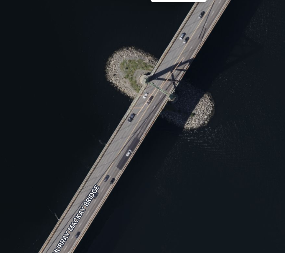

In my town (Halifax, Nova Scotia) we have two suspension bridges that those behemoth container ships go under on their way to the dock. The newer bridge was built in 1970 but the bridge piers have been upgraded over the years. Compare the Halifax bridge with the Francis Scott Key bridge pier that was hit. Water depth at the bridge pier in Halifax is about 50' versus about 25' in Baltimore.

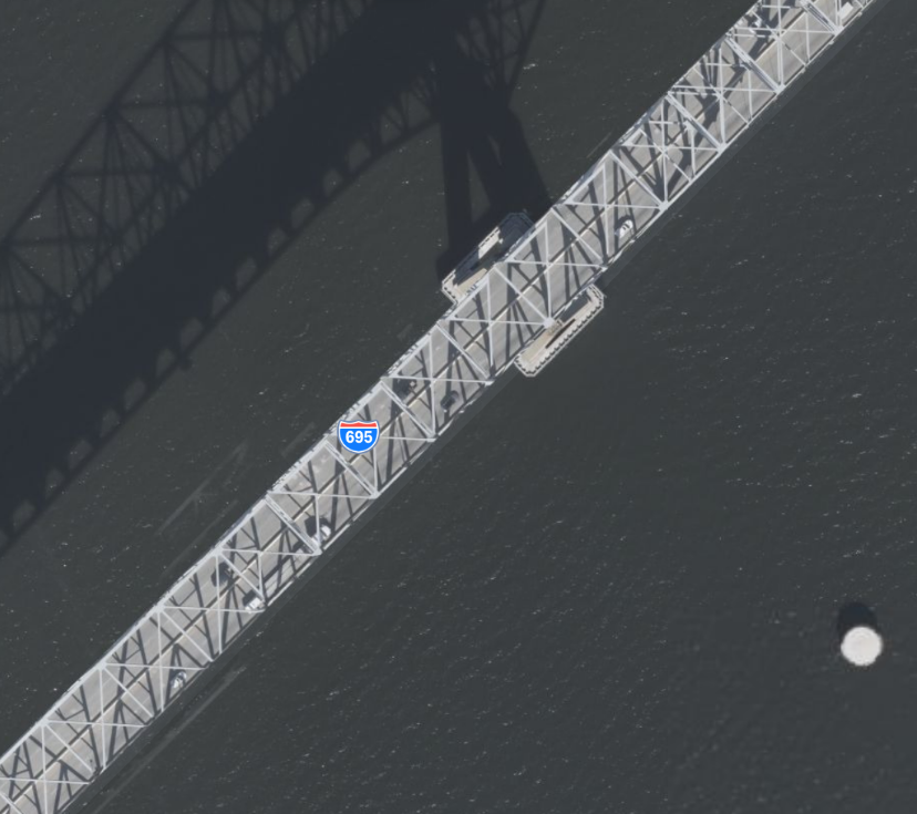

One of the key defenses against ships hitting bridge abutments where not in place on this bridge. So called "Dolphins" were not in place as a first line of defense. Many bridges in the Philadelphia area have them. One of the key items pointed out just after the incident and reported by the news. Had they been in place, it may have reduced the amount of damage and lives may have not been lost. Right wrong or indifferent, just a little addition to add to the pot!
