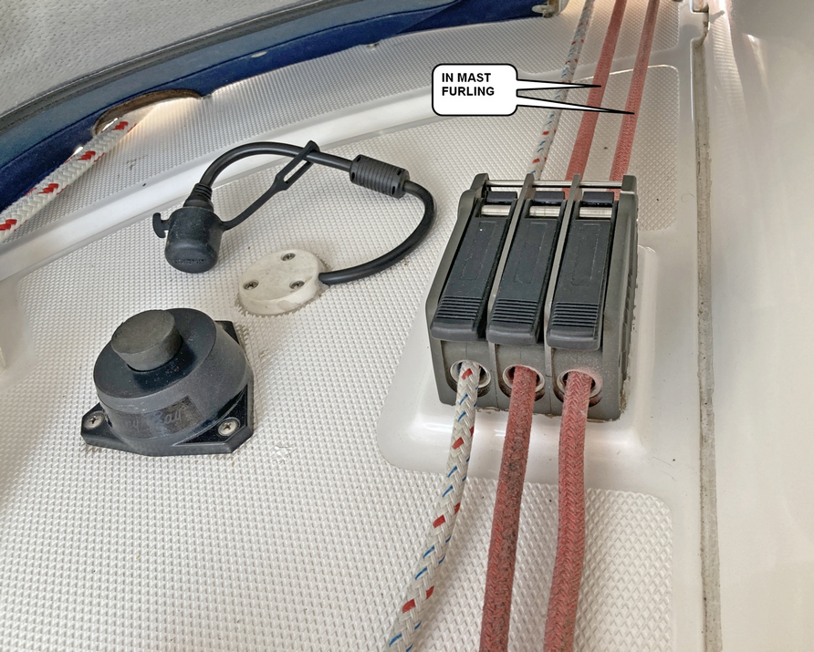

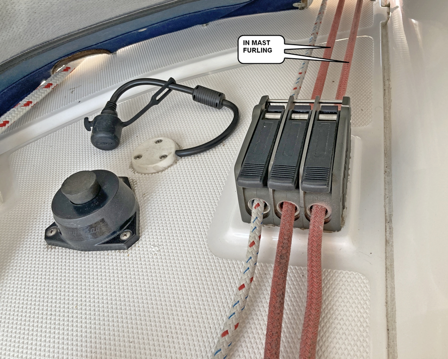

This is the arrangement of the furling line in the cockpit:
The two red lines have been gripped together, tugged by hand and then both rope clutches slammed shut.

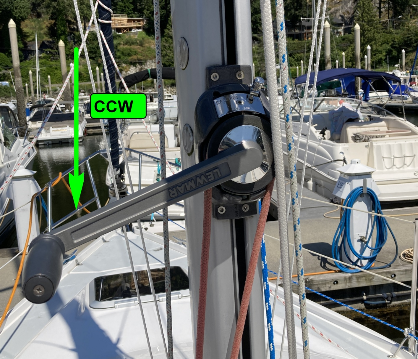

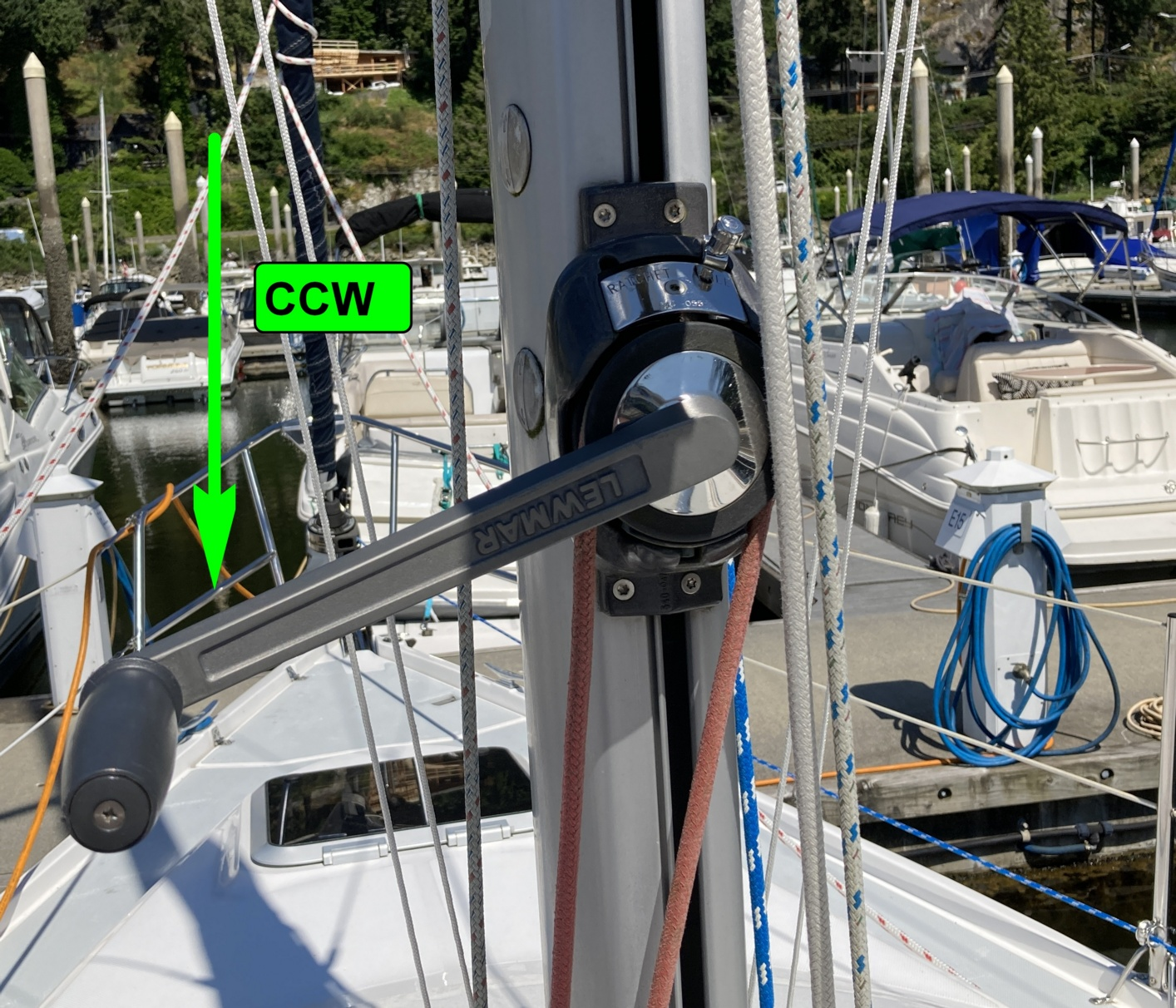

This is the arrangement at the mast:
The winch is unlocked and a winch handle has been inserted into the furling winch. CCW turning unfurls the sail. The winch handle is cranked CCW until it is ready to tear the RH section of the rope clutch off its mounting. The handle is then turned CW and again it is now ready to tear the LH section of the rope clutch off its mounting. Back and forth repeatedly and it jams every time. If you look inside the winch plates, the faces are covered with heavy radial protrusions which force the furling line towards the centre of the winch. It has to jam.
