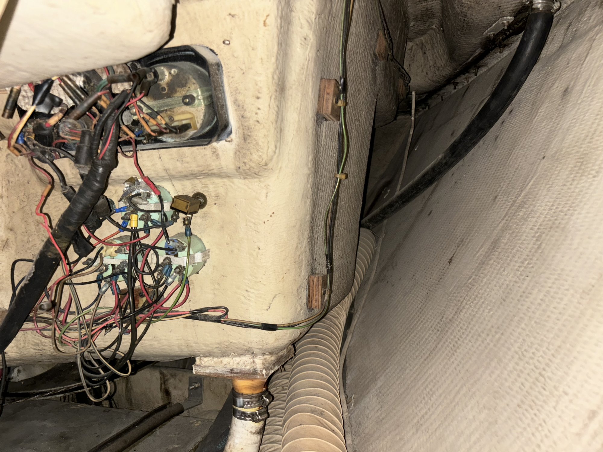

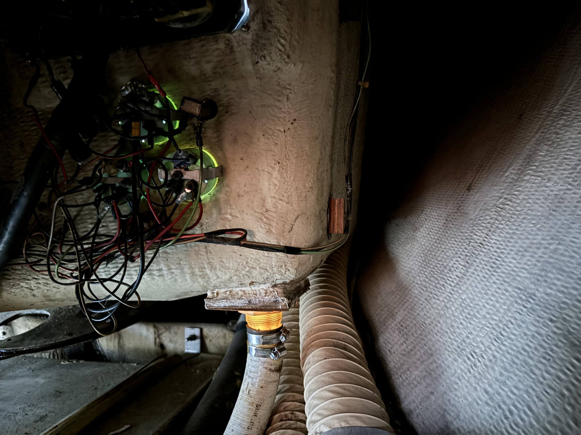

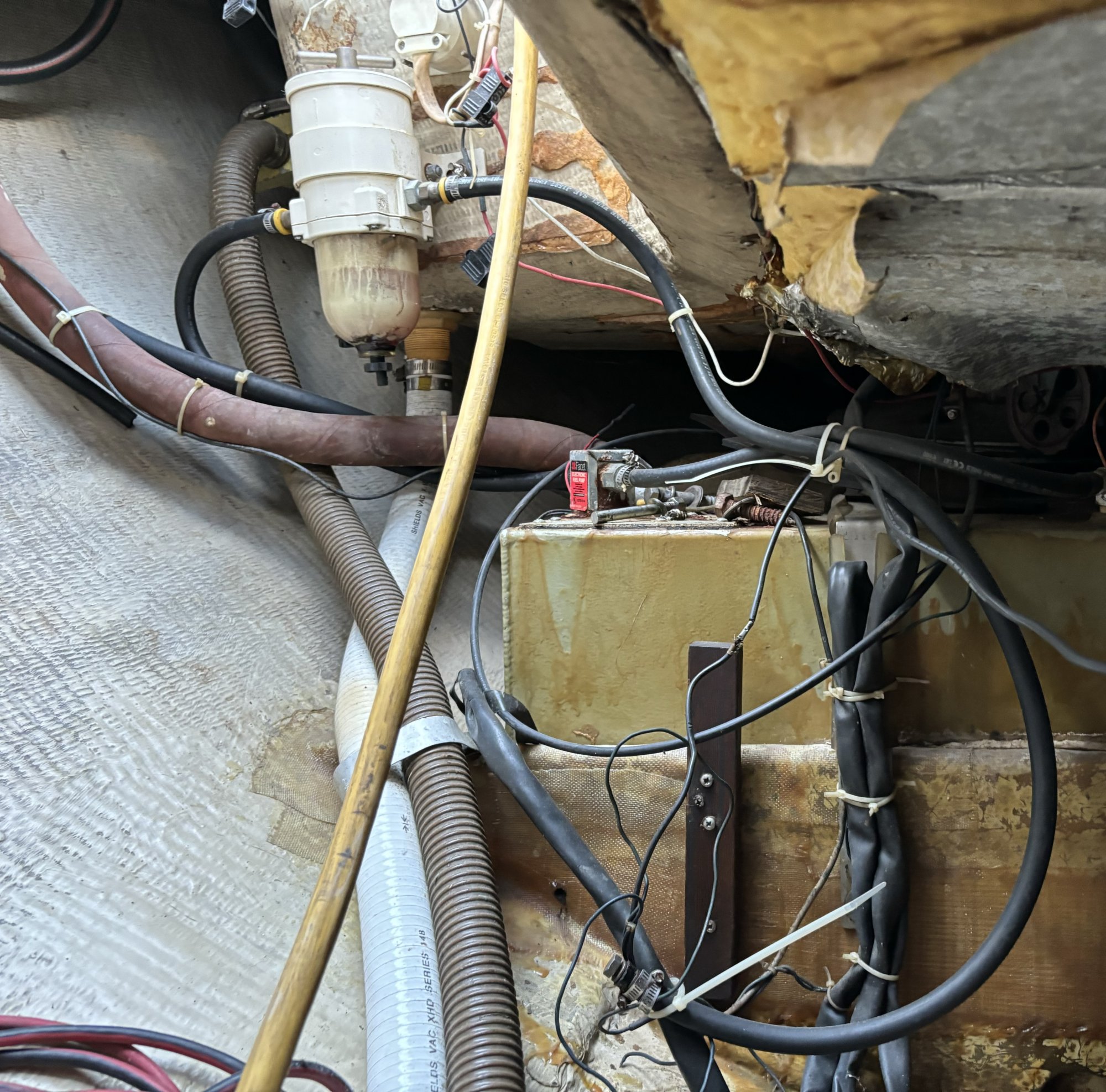

I have the same issue with my 1981 landfall 38. I have sat and stared at this engine compartment for hours and cannot seem to come up with a solution to get access to those aft seasick, side deck drain hoses and the lifeline stanchion screws.
I thought about removing the steering gear but that would only leave about 9 inches between the top of the fuel tank and the bottom of the cockpit.
there has to be a wad to access this aft area but I just can’t see it. How have you replaced your hoses?
Even the aft quarter berth access hatch is not big enough to squeeze through. I can see the nuts and bolts on the deck flange, lifeline stations but again, how in the world do you squeeze back there to access them????
