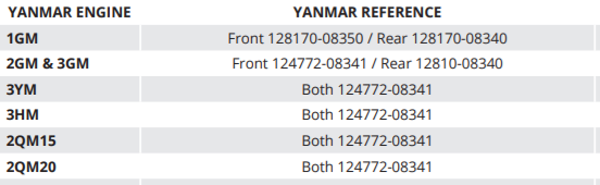

I am having difficulty identifying the proper part number for the 2QM20. Existing mounts are shot, and need to replaced. Lots of info for the 2GM20 mounts on the web ... does anyone know if the engine mounts are interchangeable for these two Yanmar models?

Is this what you found? You can purchase them from your favorite chandlery and ask them to verify the part number.
