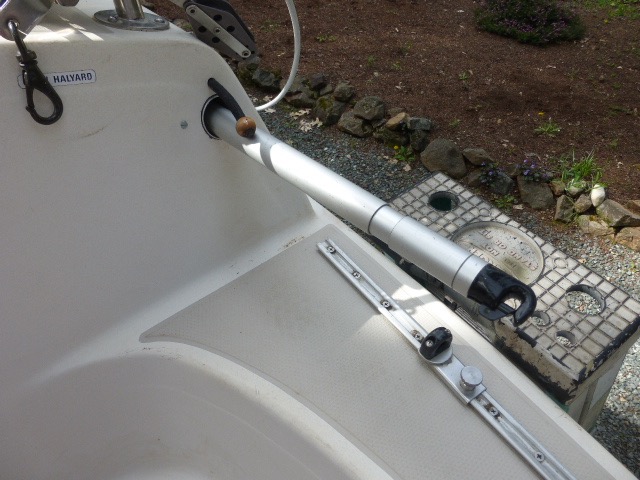

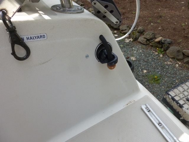

Nice! Any issues with water entry?And when you're tired of it always being in the way, when not in use, install an aluminum tube between the cockpit and head wall for the pole to slip into. always quickly accessible when needed, yet out of the way when stowed
View attachment 184907View attachment 184908View attachment 184909
Nope. I figure if lake water gets up to that level I have a bigger problem and for rain the tube is plugged in the forward end and calked where it fits in the cockpit wall.Nice! Any issues with water entry?
lol yeah I was thinking of rain. On principle I'd consider a plug for when the pole is out, as that close to the edge could allow flooding on a knockdown.Nope. I figure if lake water gets up to that level I have a bigger problem and for rain the tube is plugged in the forward end and calked where it fits in the cockpit wall.
Water can't enter the cabin through the tube, as the forward end is plugged.lol yeah I was thinking of rain. On principle I'd consider a plug for when the pole is out, as that close to the edge could allow flooding on a knockdown.
Storing the pole up the mast seems good if the mast is always up. Your solution seems perfect for a trailer boat.
Awesome thanks for clarifying!Water can't enter the cabin through the tube, as the forward end is plugged.
